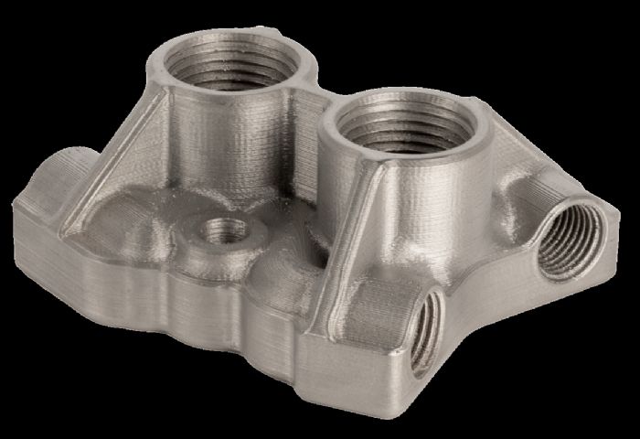

In another application, building an air manifold for use on EOA tooling actuators, the cost savings is even more significant. Kools estimates that building the manifold on the Studio System cost just $77, compared to around $300 using a conventional machining process. In addition, using AM’s ability to print complex internal channels, Egar was able to consolidate a complex multiple-part pneumatic manifold system into a single component. And, the printed manifold is smaller than the CNC-machined part, helping to avoid interference with other machinery in service.

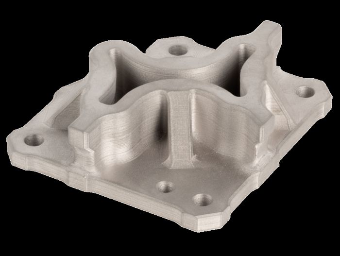

Finally, Egar has printed die sections from H13 tool steel and 4140 chromoly steel. The H13 section was fully heat treated and the 4140 part flame hardened to increase their hardness, enabling them to stand up to the stamping process. 3D printing allows Egar engineers, says Kools, to quickly create die sections for its production lines, and to retool and refit in a matter of days as opposed to weeks or more. 3DMP
