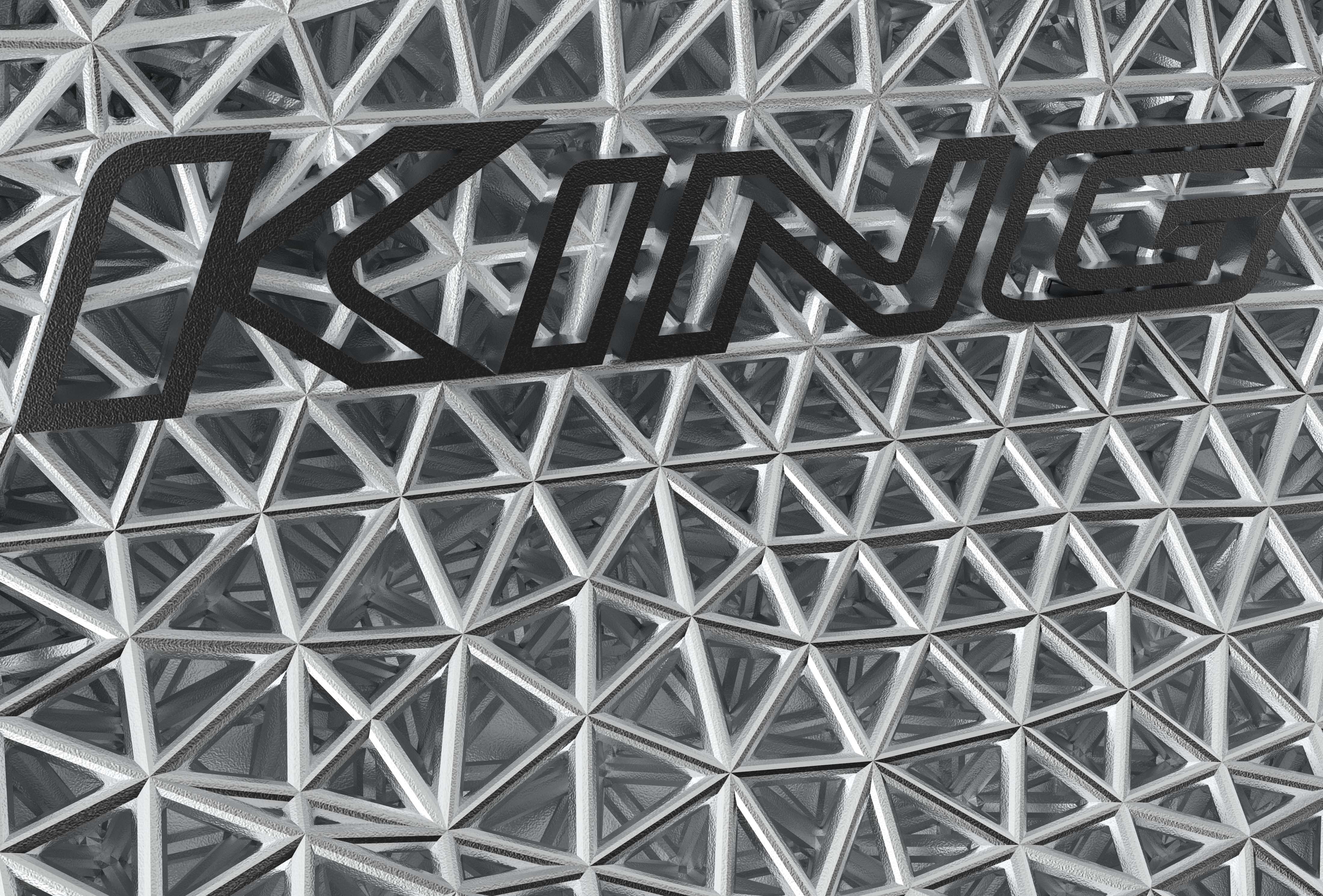

The ability to form lattice to maintain strength while lightweighting is one of many advantages cited by Cobra Golf in employing 3D metal printing for golf-club construction. Photo courtesy of Cobra Golf.
