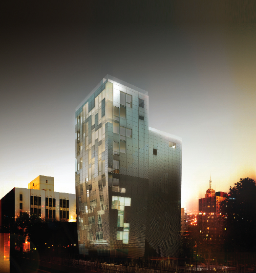

“DVB’s architects had established criteria for these embossed panels,” reports Dennis Lowry, Mate’s custom engineering manager, “which initially proved unattainable. We then recommended employing a design-for-manufacturing process along with Todrin and DVB. Together we designed just the right forming tool to develop the proper balance of tension and compression on the sheet in order to generate flat, nice-looking finished panels with the properly sized diamond-shaped embossings.”
Initially, Lowry had designed a Mate Ultra Tec tool to emboss 1.4 by 2.75-in. diamond shapes on the sheets—of 0.048-in.-thick Type 304 stainless with a no. 4 finish. The fully guided thick-turret Ultra Tec punching tools are designed to optimize tool life and allow interchangeability with existing tooling systems, according to Mate officials.
To attain the high degree of consistency and surface finish required of the embossed stainless-steel panels
To attain the high degree of consistency and surface finish required of the embossed stainless-steel panels—36 by 60 in., with symmetrical rows of raised diamond shapes across the entire sheet surface —was development of a fully guided forming tool that ensures the proper balance of tension and compression on the 0.048-in.-thick sheets.
Finn-Power ran the new Ultra Tec tool to produce 12 full-size sample sheets, which it shipped to DVB for evaluation. DVB architects approved the process, which led to Todrin acquiring the Finn-Power press along with a full suite of Mate tooling. The tooling package included three additional special Ultra Tec tools for embossing 1 by 2-in., 0.375 by 0.375-in. and 0.562 by 1.25-in. diamond shapes in the required row patterns.
