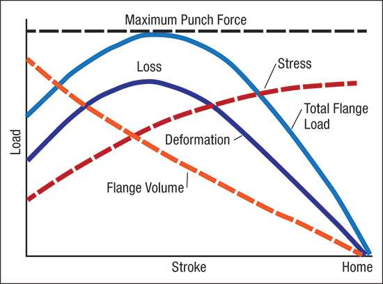

These load-stroke curves show what happens to the sheetmetal being formed into a deep-drawn cup.
Fig. 2—These load-stroke curves show what happens to the sheetmetal being formed into a deep-drawn cup.
The new setup applies force to the blankholder in smaller but increasing increments. All 24 cylinders contact the blankholder before the blank reaches the punch, so no total restraining force is sacrificed and the blankholder no longer bounces off of the blank. The video camera provided all of the data needed to solve the problem.
Lastly, consider the force diagram shown in Fig. 2, used to diagnose wall breakage during deep drawing of cups. The product of forming stress times flange volume represents the load or force needed to pull the blank into the die to form the cup wall. As the cup forms, the volume of the flange decreases—offset by increased stress due to workhardening of the sheetmetal. Because the stress increases parabolically, the maximum load point occurs about one-third through the stroke. The loss added to the deformation load results from friction and the bend-unbend deformation of the sheetmetal flowing over the die radius.
If the cup breaks during the first 10 percent of the stroke, the most likely cause is a blank too large to be pulled into the die. To verify this, we compare the blank diameter of the partially formed cup to the initial blank diameter. If they are the same, the blank never had a chance to feed material into the deformation zone.
Breakage at the maximum load usually means that the draw ratio (blank diameter divided by punch diameter) exceeds the maximum allowable limiting draw ratio—2.0 to 2.2 for most metal alloys.
Failure during the final two-thirds of the draw process should not occur, because the force now is less than the maximum failure force. Attention then would shift to very high friction or flange waves/buckles jammed at the die radius, due to insufficient blankholder force. MF
