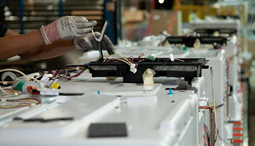

State-of-the-art appliances such as these refrigerators demand inclusion of intricate smart components, a challenging assembly task. Photo courtesy of GE Appliances |

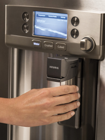

Like other appliances, refrigerators increasingly incorporate smart features and other amenities, such as this water dispenser and coffee brewer. Photo courtesy of GE Appliances |
OEM designers focus on kitchen and laundry as independent spaces. For all appliances, the use of stainless steel continues to be strong, with colored stainless steel quickly growing market share and many colors currently in development. American Trim’s lab provides color-matching capabilities to assure the meeting of these color requirements. Paint and prepaint applications are significant for laundry, but limited for kitchen appliances as they migrate to stainless. Customers find that stainless steel and aluminum components provide a durable finish with many color and brush options. This meets end consumers’ desires for authentic, eco-friendly materials.
OEMs focus on the user interface and consumer interaction with panels, which also provides a place for brand placement. There is a movement away from rounded, soft designs to crisp, tight designs. Acceptance of unique corner and edge treatments to accomplish tight-radius designs are accomplished with both decorated stainless steel and aluminum consoles. Mixed metals and materials are a growing trend, such as aluminum panels with a polycarbonate overlay.

Smart technology significantly affects appliance design and the manufacturing process. Specifically, electronics integration into the control panel represents a primary design factor. The need for strong Wi-Fi connections to the CPU of appliances has reshaped the design and testing procedures of the machine and user interfaces. Material selection for traditional components to accommodate Wi-Fi is still in transition as suppliers and OEMs work to overcome the barriers to RF connectivity. Approaches have included using larger display areas for metal panels, forward placement of hidden RF antenna elements within the display envelope, and consideration of other elements such as interference from an open metal washer lid. American Trim invested in modeling analysis of several Wi-Fi antenna and integration approaches to ensure their ability to provide the IoT solution paths that OEMs increasingly desire. In many cases, the best solutions have remained dedicated RF antennae at the perimeter of the machine to enable reliable signal quality without interference from the machine structure and power elements.

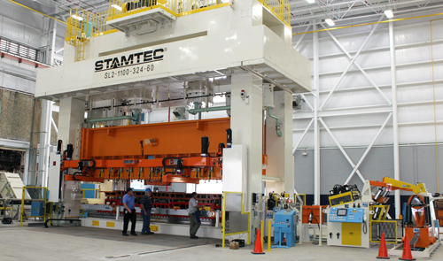

The Roper Corp. plant expansion in Fayetteville, GA, accommodated two new transfer presses, enabling the plant to increase its metal fabrication capability as part of a program to insource metal parts. GE Appliances reports that it invested $43 million to create new manufacturing capacity and products at the plant. Photo courtesy of GE Appliances |
