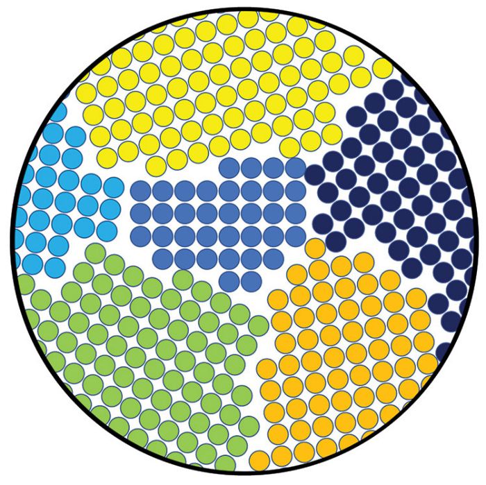

Fig 2While the type of crystal structure is consistent throughout a sheet metal grade, the orientation of these crystals changes. A grouping of atoms in one orientation is called a grain; adjacent grains differ in their orientation, as seen in Fig. 2, showing a 2D representation of grains in multiple orientations. However, remember that grains grow and move in three dimensions. Smaller grains mean more orientation changes, leading to more resistance to atomic movement as sheet metals deform. This translates to higher strength. For perspective, the atomic diameter of common sheet metals typically is 0.00025 to 0.00035 microns, and an ASTM grain size of 7 equates to a diameter of 32 microns, or 100,000 times as large.
Additions of alloying elements, each with a unique atomic size, distort and strain the regular pattern of atoms. This explains why aluminum alloys and steels are stronger than the elements aluminum and iron, which typically comprise more than 95 percent of an alloy.
The distribution of different orientations is the crystallographic texture of the metal alloy. Hot-rolled steels have a random grain orientation, so properties do not vary greatly relative to the rolling direction. This contrasts with cold-rolled grades, where grains elongate in the rolling direction. This leads to measurable differences in properties depending on the orientation. Isotropic materials are those where orientation does not affect properties, while orientation influences anisotropic materials.
