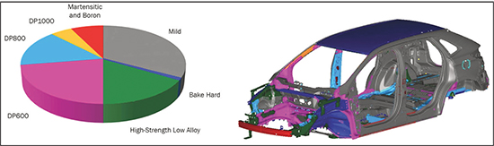

Acura TLX
To achieve the high rigidity that promotes a smooth and quiet ride, crisp steering and handling, safety performance and long-term durability, the TLX (Fig. 10) utilizes six different grades of HSS and AHSS in 52 percent of its body structure by weight. This high-grade, high-tensile strength steel adds the required rigidity for these positive traits without adding excessive weight, which in turn enhances fuel efficiency and lowers emissions. High-strength steel uses include:
• Hot-stamped HSS—Door opening rings, for five percent of the unit body
| Fig. 5—A small R/t ratio means higher percentage of outer fiber strain and a steel with a high percentage total elongation. |
• 980 grade—Key structural points such as the front edges of the door sills and in the A- and B-pillars, for two percent of the unit body
• 780 grade—Most structural load paths, including the side sills and forward spars of unit body, for two percent of the unit body
• 590 grade—Front frame spars, floor and roof supports, for 35 percent of the unit body
• 440 grade—Front bulkhead and in front and rear energy-absorbing structures, for five percent of the unit body
• 340 grade—Sheet steel used in the roof, for three percent of the unit body.

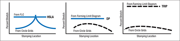

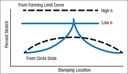

| Fig. 6—The higher initial n-value of DP steel helps to suppress early strain gradients. |

Fig. 7—The development of a 0.25 n-value allows a major increase in overall stretchability over HSLA and DP steels.

Fig. 8—How three 50-ksi yield-strength steels can modify the forming problems of initial peak strain and low forming-limit curve.
