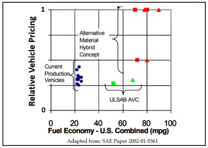

In the first decade of the 21st century, when the automotive industry needed materials to support lightweighting initiatives, achieve aggressive fuel-economy targets and maintain passenger safety, the American steel industry collaborated with global consortia to create the Ultra-Light Steel Autobody (ULSAB) design project.  That project, using a current-model sedan as the basis for study, resulted in a design that optimized the vehicle structure and projected significant weight reductions using available and current advanced high-strength steel (AHSS) grades.  ULSAB led directly to a larger, more comprehensive project called ULSAB-Advanced Vehicle Concept (ULSAB-AVC), which fully demonstrated achievable 20-percent body-in-white (BIW) mass-reduction using existing manufacturing infrastructure with new steel grades and at a competitive market price (Fig. 1). These projects signaled the beginning of close cooperation of the engineering organizations within both industries.
ULSAB-AVC-body-in-white-mass-reductionFollowing the initiatives centered around the ULSAB and ULSAB-AVC achievements, seven American steel industry producers participated in a global initiative to illustrate even further opportunities for advanced steel grades in automotive design. Partnering with global steelmakers via WorldAutoSteel, the project known as FutureSteelVehicle (FSV) demonstrated a feasible automotive architecture utilizing 95-percent high-strength and AHSS steel with more than half of that being grades more than 1000-MPa tensile strength. FSV highlighted a steel-body structure that achieved more than 35-percent weight reduction over a benchmark vehicle and reduced total life-cycle emissions by nearly 70 percent. The FSV project clearly demonstrated a feasible automotive design with significant use of newer AHSS steel grades and highlighted the use of many recent forming and joining technologies not yet mainstream.  For more information, visit www.worldautosteel.org/futuresteelvehicle-reports.

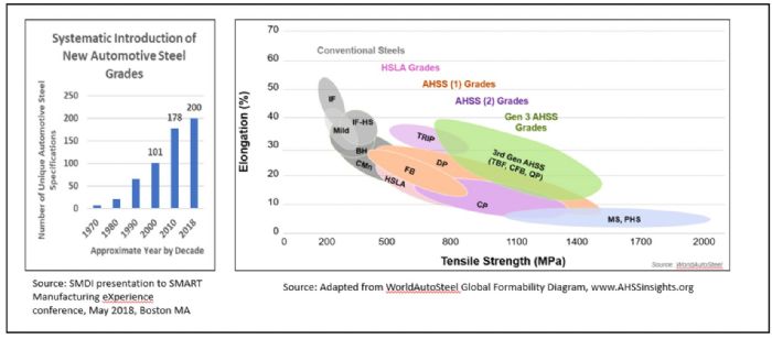

FSV paved the way for further and continuing cooperation of the steel and automotive industries as more advanced steel grades became available. Innovations in steel-grade development to meet the automotive industry’s needs were leveraging steel’s metallurgical potential to produce even higher-strength formable grades for automotive applications. This effort and progress is evident in the increasing number of commercialized steel grades, which grew from just slightly more than 100 variants in the early 2000s to well over 200 grades in 2018.
3rd-Gen-AHSS-steel-gradesThe technological development of new steel grades hasn’t stopped, and recent advancements in steel-mill processing capabilities support the development and full-scale production of 3rd Gen AHSS grades capable of 1500-MPa tensile strength with more than 20-percent total elongation.  Fig. 2 illustrates this progress in the determination and introduction of new steel grades along with strength and ductility relationships. The combination of high strength and improved ductility in the mechanical properties of 3rd Gen AHSS grades offers a comprehensive advantage for cost efficiency in the automotive industry as they provide the required materials for forming complex automotive geometries via cold forming.
