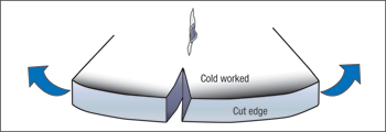

The worst mode of deformation for inclusions is edge elongation (stretch). Here a tensile stress follows the contour of the cut edge (Fig. 2). Unlike the as-received properties available at the start of the deformation for the sheet stretching and bending described above, the stretchability of the normal blanked edge has been highly degraded by the severe cold work created by the cutting, blanking, slitting, trimming or shearing operations. This greatly reduces the allowable edge stretch even for inclusion-free steel. When an inclusion intersects this cold worked edge (Fig. 2), a natural crack starter is present that reduces the allowable edge stretchability even more.
Fig. 2—A crack usually occurs at the cut edge that has reduced stretchability due to work hardening and the notch effect of an intersecting inclusion. |

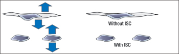

Fig. 3—The MnS inclusion without ISC act as notches and crack starters. This danger is minimized by the rounded inclusions formed with ISC. (Y. Bilimoria & N. Lazaridis, Arcelormittal, 9-11-2000.) |
Early metallurgical procedures to minimize the adverse effects of MnS inclusions are called Inclusion Shape Control (ISC). Mischmetal (rare earth) or calcium is added to the molten steel to combine with the globs of MnS to change their final properties and shape of the inclusion segments from elongated to circular (Fig. 3).
