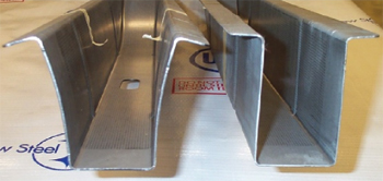

April 1, 2009Springback, sidewall curl and panel twist all have their origins in unbalanced stresses in the formed part. These may be inherent in the product design due to nonsymmetrical geometry and cutouts, rapid changes in cross-section, or unequal flange lengths. They may be equally inherent to the forming operation due to the number of highly interactive process parameters. These include die-process lubrication, die-polishing techniques, blankholder forces, blank positioning, and broken or worn draw beads, just to name a few.
Some compensation for springback is routinely designed into most forming processes to limit or reduce the number of additional over-bending or restrike operations. The method and magnitude of compensation usually depends on the die designer’s experience with similar parts, materials and processes. The arrival of new higher-strength steels dramatically changes the old approach to springback compensation because previous experience with these new materials does not exist.

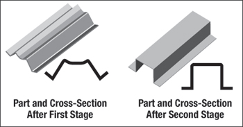

Because springback is a major concern in higher-strength applications, it must be addressed as early as possible in the design phase. Springback can be minimized in the product design phase by:
Fig. 1—Avoid right or acute angles when forming higher-strength steels. |
• Avoiding right or acute angles (Fig. 1).
