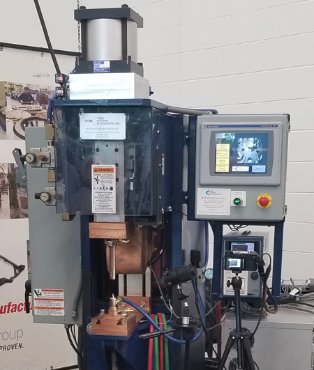

Attendees of MetalForming magazine’s Hot Stamping Experience and Tech Tour, held this past September in Michigan, had an up-close look at capacitor discharge (CD) resistance welding, courtesy of this CD welding machine. The process promises quality welds of softer fasteners to harder hot stamped steels.

A major aspect of hot stamping concerns joining, including the projection welding of fasteners, as these parts make their way into larger components and assemblies. Installing fasteners on hot stamped aluminum-silicon (AlSi)-coated parts can be tricky business owing to a number of factors, according to officials from Weld Systems Integrators (WSI), which provides systems for CD resistance welding in hot stamping applications. Bob Kollins, senior application engineer with Technical Sales & Solutions, which works with end-users to set up and operate stand-alone Amada Miyachi-powered CD welding units from WSI, along with Allen M. Agin, WSI Midwest regional sales manager, described and demonstrated fastener-welding challenges and solutions at MetalForming magazine’s Hot Stamping Experience and Tech Tour, held this past September in Michigan.
Especially in hot stamping applications, fasteners are extremely soft as compared to the base material, causing the fastener projections to collapse before a good weld is achieved. In addition, hot stamped materials develop an AlSi coating in the furnace, with the resistive qualities of the coating inconsistent across the hot stamped part. On top of that, the short weld times called for in projection welding bring difficulty in delivering enough heat to the base material.
CD welding stores energy for rapid energy release with large peak currents, which means more energy into weld formation and less into heating the surrounding material, as well as a smaller heat-affected zone as compared to other welding processes. In metallurgy-critical hot stamping, these attributes prove advantageous, which is why, despite the above-listed challenges, projection welding of fasteners to hot stamped parts sees wide use.
“Since 2007, we’ve worked with Tier Ones and OEMs producing and processing hot stamped parts inhouse,” says Kollins. “Typically, materials arrive at a Tier supplier ready to be stamped. Hot stamping, on the other hand, involves inhouse processing, which varies from manufacturer to manufacturer. Variations exist across the industry and even across a part in terms of contact resistance, specifically at the interface where the fastener attaches to the part.”
CD welding technology, Kollins explains, can work with these variations by altering the weld current to match the current needed for resistance at that particular location on the part. Today, Kollins and Agin see a rise in hot stamping usage and applications, and continuously work on developing welding technology, such as a newly released machine and monitoring capability, to account for trends, including the use of thicker material. MF
