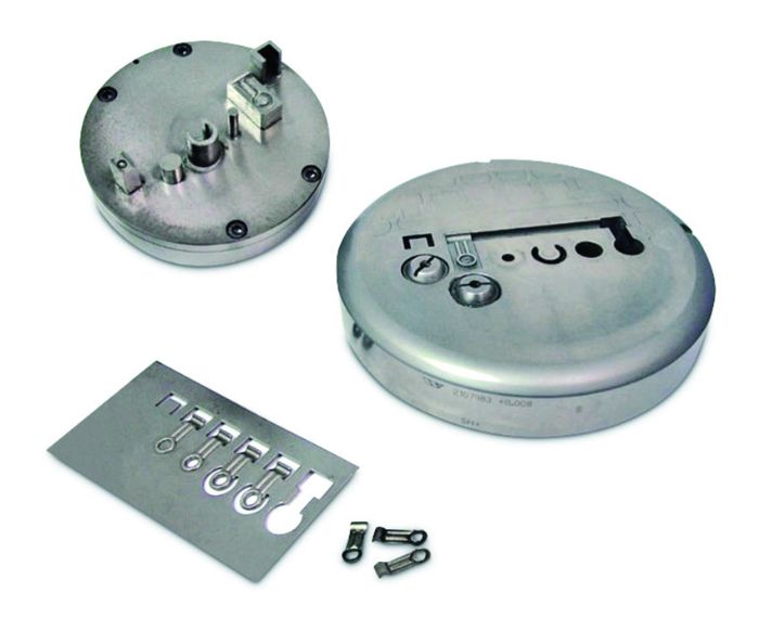

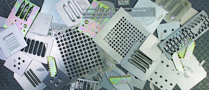

Beyond basic hole punching, AHSS frequently find use in parts designed for airflow management, incorporating complex features such as louvers and custom hole patterns. Forming louvers in AHSS requires precise control of the forming process to prevent cracking and ensure consistent louver geometry. Specialized tooling designs, incorporating progressive forming steps and sharp cutting edges, prove essential.
Creating complex hole patterns in AHSS can be challenging due to the increased punching force and potential for distortion. Advanced tooling designs, such as staggered cluster punches and hole layout, can optimize the punching process and ensure accurate hole placement.
Whether incorporating louvers or custom hole patterns, fabricators must work to design products that optimize airflow efficiency. A useful tool here: computational-fluid-dynamics simulations, which analyze airflow patterns and optimize the design.
