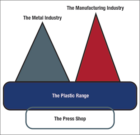

The two mountain peaks represent the respective knowledge bases of steelmakers and users. One learns about the topics by climbing the mountains; the space between represents a lack of communication.
Swift established a series of theoretical hills (see accompanying illustration) that metallurgists needed to climb as they studied the huge volume of historical knowledge published by prior metallurgists. Not restricted, the metallurgists now understood the basis of existing science. Starting from the foothills, each higher area of the hill represents increased success. Their advanced information (1900s) still finds use today:

Note the large gap between the two peaks in the illustration, which represents a lack of communication between steelmakers and users. Efforts to close this gap are being made by newly minted “formability engineers”—people who have completed university-level instruction and on-the-job training, and have experience in metalforming.
