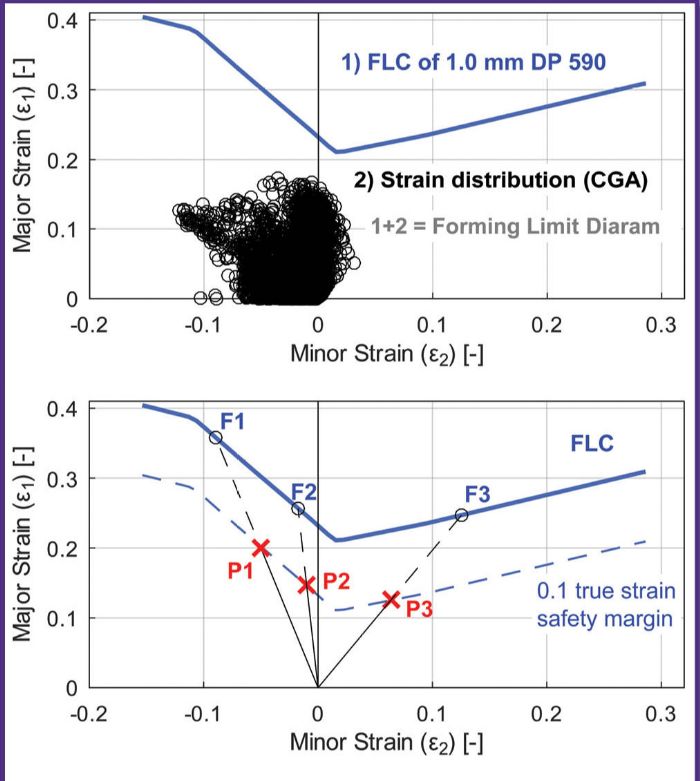

During the past two decades, most process and tool designers have relied heavily on sheet metal forming simulations. When trying to assess the risk of crack formation, users of simulation tools often rely on a parameter known as the maximum failure criterion. To calculate this criterion, one must create an FLD that combines the forming-limit curve (FLC, representing a material property—Fig. 1, blue curve), and the strain distribution (representing the process outcome—Fig. 1a, shown with more than 4000 dots). To determine the strain distribution, designers can use simulation software, or analyze the physical stamping using circle-grid analysis or other optical techniques.
The maximum failure criterion corresponds to the strain distribution closest to the FLC. When the failure criterion reaches 1 (or 100%), it indicates necking in the part. As expected, when the criterion exceeds 100%, the likelihood of cracks occurring becomes very high. Most tool designers aim to design a process with a maximum failure criterion of 0.7 (or 70%) for a part, depending on FLC-curve reliability. Despite this margin, the occurrence of edge cracks or splits still can be observed.
To assess the risk of a necking-based failure, three methods find use:
  1. Applying a safety margin (Fig. 1b), by moving the FLC down by a fixed amount of strain, typically 10%.
  2. Maximum thinning, the easiest method to check on the shop floor.
  3. Maximum failure criterion: distance of strain distribution points to the FLC. For example, in Fig. 1, the failure criterion of P1 is the distance O-P1 divided by distance O-F1, corresponding to 0.56 (56%).
Fig.2Per Fig. 1b, all three points are on the same 10%-safety-margin curve. The thinnest point would be P3, but the maximum failure criterion would be observed on P2. So, although all three methods are used, the most common (and the safest) would be the maximum failure criterion.

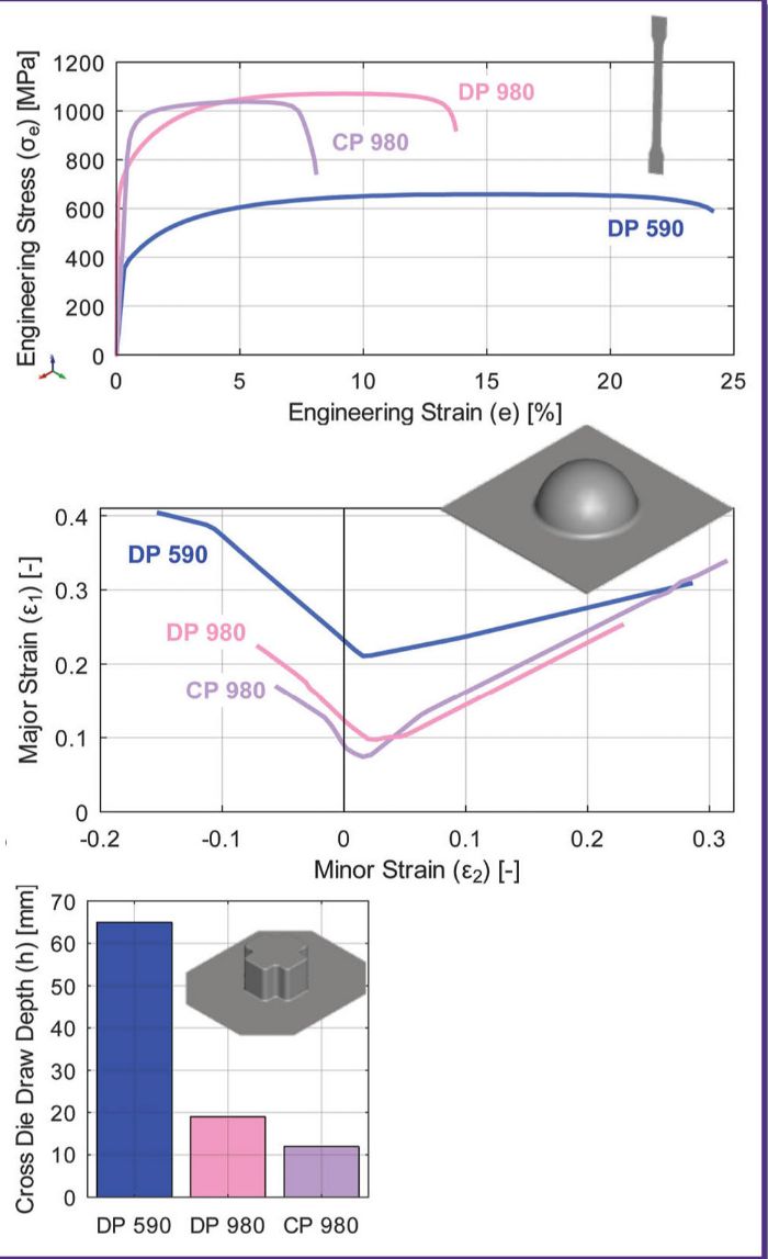

Heibel et al investigated a number of AHSS grades using several formability tests. Fig. 2a illustrates the stress-strain curves of DP590, DP980 and CP980. Notably, with a tensile strength of 980 MPa, DP980 exhibits an elongation of nearly 14%, while CP980 achieves only about 8%. In contrast, DP590 can withstand a tensile strain of 25%.
Per Fig. 2b, displaying the FLCs for each alloy, we see DP590 at the top and CP980 at the bottom. Based on both graphs, one might assume that the highest formability would be found in DP590, followed by DP980, and the lowest formability in CP980.
As expected, when subjecting these grades to deep drawing using a cross die (Fig. 2c), DP590 exhibited cracking at a depth of 65 mm. DP980 followed with a crack depth of 19 mm, and CP980 showed cracking at a depth of 12 mm. These results align with expectations. Uniform elongation (UE), total elongation, n-value, minimum point on the FLC and deep drawability all are considered measures of global formability, or resistance to necking failure.

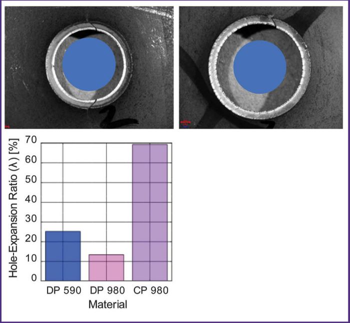

In the Heibel 2018 study, the steel grades also were hole-expansion tested. DP590 achieved a hole-expansion ratio (HER or λ) of approximately 25%. This means that when punching a 10-mm-dia. hole, expanded using a 60-deg. conical punch, a crack typically would occur when the inner radius reaches about 12.5 mm, representing a 25% increase in hole diameter before cracking.
DP980 exhibited a lower HER of only 13% (understandable given its increased strength), resulting in reduced formability. However, CP980 demonstrated an exceptionally high HER of nearly 70%. This outcome does not align with the expectations derived from Fig. 2. CP980 has the lowest FLC, and lowest uniform and total elongation values. Note: Figs. 3a-b come from a different study.

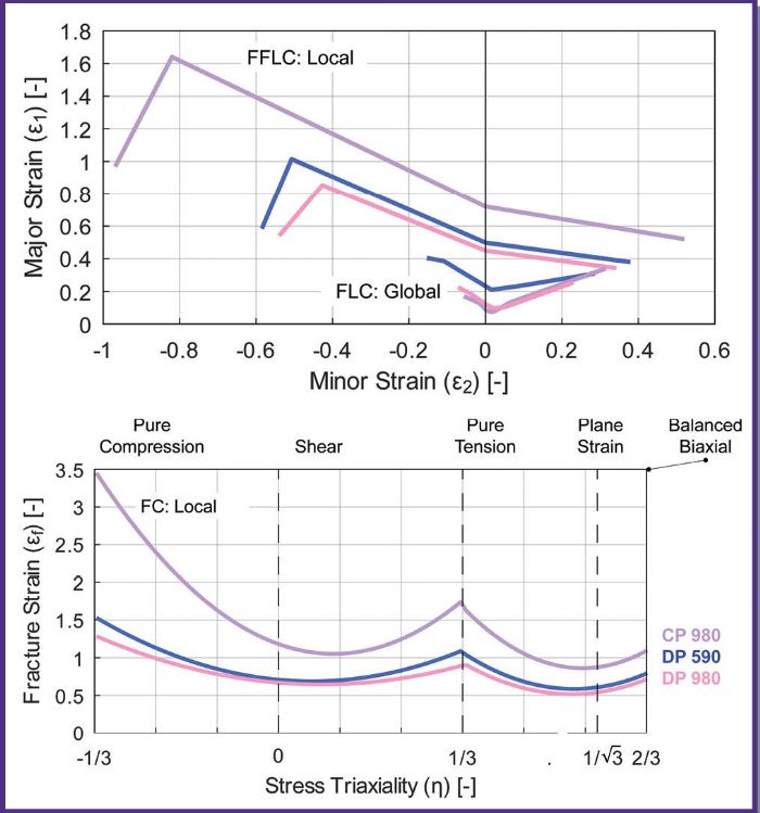

Fig. 4Using the various tests and calculations allows engineers to generate a failure forming-limit curve (FFLC). Another failure curve commonly used is the fracture curve (FC). In an FFLC, the X axis shows minor strain and the Y axis shows major strain, just like an FLC. With an FC (Fig. 4), the X axis shows stress triaxiality (a stress calculation beyond the scope of this article) and the Y axis shows fracture strain.
In some forming modes, including roll forming or incremental forming, the limit of formability does not relate to global formability. In roll forming, bending (by the moment created by the rolls) represents the major deformation mode. The key mechanical property to be measured: bendability. And, when simulating incremental forming, FC or FFLC methods can be used.
What may be striking in these graphs (Fig. 4) is the low global formability of CP980 and a high local formability. These properties suit the alloy well for bending, roll forming and incremental forming, and for parts containing severe stretch flanges and hole expansions. This material is not a good choice for deep drawing.
