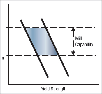

Fig. 1—Mill capability shows the property range expected for a specific steel type and grade.
High on the priority list is correctly identifying the type and grade of sheetmetal required for a given set of tools. Consider this actual case study, using aluminum-killed draw-quality (AKDQ) steel where forming a part required severe stretching. The maximum useable stretch for any steel depends on the work-hardening exponent, or n-value: n-value decreases as a steel’s yield strength increases (Fig. 1). Knowing the distribution curve of n-values for AKDQ steel produced by the supplying steel mill, we can create a set of boundaries—called mill capability, as seen in Fig. 1.
One must be careful to use the correct distribution data. Obviously, steel produced for simple high guard rails will exhibit different properties than will steel produced for a complex-shaped oil pan. Therefore, do not use a distribution curve developed for all AKDQ steel from a given mill for all customer products. Instead, steel mills can provide a series of process codes that details the exact composition and processing parameters used to produce the steel for forming different types of parts. You need the property range for the process code that closely matches the forming requirements of your specific application. If you are going to order steel directly from the mill over an extended length of time, some mills will create special process codes just for your difficult parts.

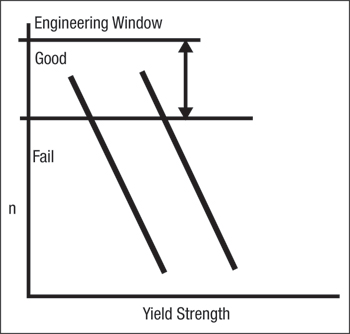

Fig. 2—Engineering window shows the steel property range required to produce a satisfactory part.
Another curve can be constructed that shows n-value limits that will allow forming of an acceptable part (Fig. 2), typically referred to as the engineering window. If n-value is too low the part will neck and tear, and
if n-value is too high the distribution of stretch will change and cause cosmetic defects such as loose sheetmetal, buckling, or low or high spots. Determine the n-value range required by the part by using virtual forming, circle grid/FLC analysis, or via test runs of steel samples having different n-values.

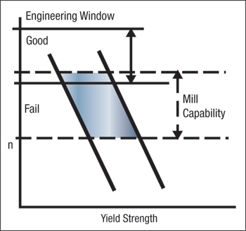

Next we overlay Fig. 1 and Fig. 2 to create Fig. 3—the proper AKDQ steel-product match exists when the engineering window encompasses the entire mill capability. This indicates that all properly made steel should produce acceptable parts.
Unfortunately, this did not happen with the actual case study illustrated in Fig. 3. Here
Fig. 3 Yield Strength
Fig. 3—Overlaying the engineering window and mill capability reveals potential production problems.
the engineering window requires a higher n-value than normally supplied by the steel mill. When the customer tried out the tool in its press shop with a coil of the intended production steel (mid-range n-value), most of the parts exhibited necks or tears—a major problem. The vendor that built and tried out the tool argued it was not his fault because the purchase order simply specified the use of AKDQ steel. The vendor used AKDQ steel from its stock supply, and it made all good parts. When tested, the vendor’s steel had an n-value in the upper 20th percentile of the normal property distribution provided by the steel mill. The steel supplier argued that it had given an honest property distribution and could not be required to only supply AKDQ steel with properties in the upper 20th percentile. The steel supplier did suggest that a vacuum-degassed interstitial-free steel with higher n-values would better fit the engineering window. However, the press shop did not want to pay the extra cost for the steel or for reworking the tooling.
