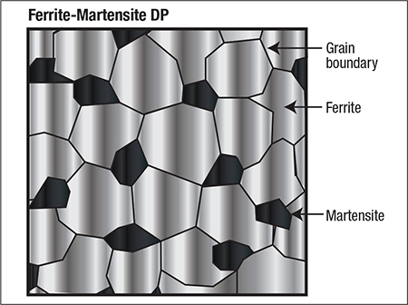

The microstructures of the different types of steel comprise a variety of grain sizes, and grain size impacts an alloy’s mechanical properties. For example, the schematic in Fig. 1 portrays the grains found in a dual-phase (DP) advanced high-strength steel (AHSS). The grains making up the ferrite phase have two important, controlling features—the boundaries and cores of the grain. The grain boundaries are stronger than the cores, so to increase the strength of the steel, smaller grains are formed to reduce the size of the weaker cores. This increases the volume of the stronger grain boundaries. Grain size depends on the available heat.
Fig. 1—Schematic of a ferrite microstructure with a highlighted grain boundary. The 10-percent martensite grains exist in dual-phase (DP) steels. AHSS Application Guidelines, Ver. 5.0.
Steel types ranging from common mild steel to high-strength low-alloy (HSLA) grades are based on a ferrite microstructure. AHSS grades comprise one or more phases other than ferrite. DP steels (Fig. 1), for example, comprise a martensitic structure.

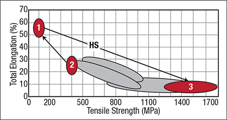

Hot Forming
Hot-formed stampings depend on heat to reduce the strength of the steel during forming. Parts then are quench-hardened to eliminate elastic springback. The process (Fig. 3) starts with a manganese-boron (22Mn5B) steel with the properties shown at location [1] on the graph. This steel is heated to 850 C [2], which decreases its yield strength to 100 MPa and allows complex deformation. After forming, the stamped part is immediately quenched in the die to form martensite. Yield strength reaches 1000-1250 MPa, and tensile strength is 1400-1700 MPa. MF
