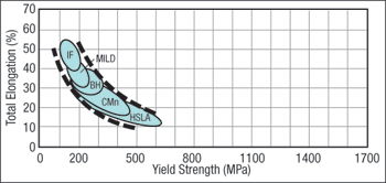

What is an AHSS? To understand this, one first must create a foundation of the traditional high-strength steels in common use. The earlier methods of creating strength included adding carbon or other elements to raise the strength of the steel. Another method was to coldwork the steel (full hard) and then often partially anneal the steel (3⁄4 hard, ½ hard, etc.). These were less expensive methods to obtain high strength but the stretchability and bendability of the steels were greatly reduced. The HSLA (high-strength low-alloy) steels have been the primary high-strength steels over the last 30 to 35 years. Produced by thermal mechanical processing, HSLA grades have yield strengths from 35 to 80 ksi (240-550 MPa). Now some HSLA steels have yield strengths of 100 and 110 ksi (690-750 MPa). Other traditional high-strength steels are C-Mn (carbon manganese), BH (bake hardenable), and IF-HS (interstitial-free high-strength).
One method to graph the relative characteristics of higher strength steels is to plot a formability parameter against the strength of the steel. Fig. 1 shows total elongation plotted against yield strength.
Fig. 1—A graphical plot (called a banana curve) that depicts change in total elongation as a function of yield strength. |

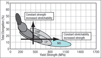

Many AHSS were created for weight reduction, where higher strength allows a reduction in sheet thickness while maintaining sufficient formability to make a successful stamping. Another driver for AHSS is increased energy absorption. AHSS achieving these goals fall into one of two groups (Fig. 2). The first group provides greater formability (in this case total elongation) for equal yield (or tensile) strengths. The primary steels in this group are the DP (dual-phase) steels and the TRIP (transformation-induced plasticity) steels. The second group provides greater yield (or tensile) strengths for equal amounts of formability. In this group are CP (complex-phase) and MS (martensitic) steels.
Fig. 2—An extension of Fig. 1 showing the four most common AHSS and their benefits. |
The highest-strength AHSS is the Martensitic steel with a 180 ksi (1250 MPa) yield strength and a 220 ksi (1520 MPa) tensile strength. Many martensitic steels have a total elongation of only 5 percent and a very low n-value. Obviously, this very high strength has limited stretchability and bendability that restrict its application to nondifficult stampings. Again, metallurgists and forming engineers have bypassed this restriction by using the HF (hot-forming) process. Here the steel blank is heated above 1560 F (850 C), formed at that temperature, and then quenched in the die. At the forming temperature, the steel has excellent stretchability. Quenching immediately after forming produces the martensitic structure without any springback issues.
