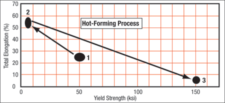

Some industries, especially the automotive industry, have created many final parts with 150 ksi and higher yield strengths by taking a radically different approach. Nothing in the RFQ says the as-received steel must start with those high-strength properties; only the final part needs to meet those specifications. These companies successfully make the parts by hot forming the steel. The premise is simple. Process low-strength steel through the following steps in the schematic: 1) External to the die, cut and preheat the blank to high temperatures to lower the yield strength for maximum stretchability, 2) Quickly transfer the hot blank to the die and form the part without elastic springback, and 3) In-die quench the part to generate the required very high-strength final martensitic microstructure. Process information is amplified below.
• While several steels can be used in the hot-forming process, the most common is a boron-manganese (22MnB5) steel. The as-received properties are 50 ksi min. yield strength, 70 ksi min. tensile strength, and a typical total elongation of 23 to 27 percent. The blank-cutting tools must be designed to withstand these properties.
• The blank is heated to a target temperature of 1650 F. In less than 10 min., the microstructure transforms to austenite. At this temperature, austenite has a relatively constant yield strength of 6 ksi and allowable elongations greater than 50 percent. Because of the high temperature, the steel needs a protective coating to prevent formation of a surface oxide.
Schematic showing properties of hot-forming steel
Schematic showing properties of hot-forming steel from 1) as-received to 2) hot forming to 3) final quenched part.
• The blank is transferred to a water-cooled die for immediate forming. At the end of the forming stroke, the punch is held at bottom dead center to allow the punch and die to quickly quench the formed part to a martensitic micro-structure. This locks in the geometrical shape of the part. The part properties now are 150 ksi min. yield strength, 220 ksi min. tensile strength and a typical total elongation of 5 percent. This is the strength specified for the final part.
