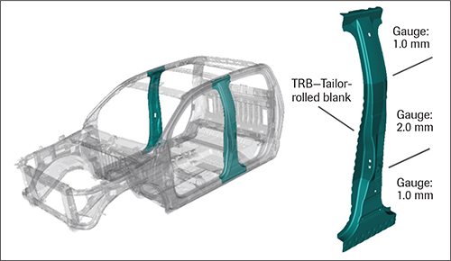

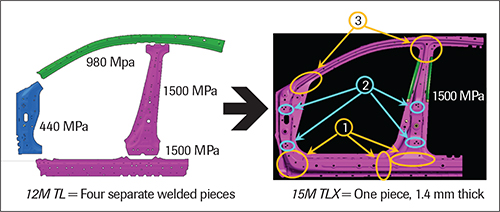

Efforts to integrate next-generation steels extend to production systems, including education of tiers leading to greater incorporation of the aforementioned hot stamping, hydroforming and rollforming processes, as well as the use of tailor-welded and tailor-rolled AHSS blanks.
