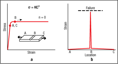

Fig. 1—Schematic a shows how zone B continues to deform to failure at a constant stress, while zones A and C remain elastic. Schematic b shows the resulting severe strain gradient.
Assume a sample of steel without any work hardening capacity is being stretched (sketch inserted into Fig. 1a). The sample has a constant cross-section from end A to end C except at zone B. Here a scratch, slight reduction in thickness, or some other reason creates a reduced cross-section at zone B. Since stress is pulling force divided by cross-sectional area, the stress level at B is higher than the rest of the sample. To initiate deformation, the pulling force is slowly increased and then halted when zone B reaches the yield strength. Since the remainder of the sample (zones A and C) has less applied stress, these locations are still in the elastic region (see data points on the stress-strain curve in Fig. 1a.) However, once started zone B continues to elongate and reduce its cross-section, thereby moving to the right along the flat stress-strain curve. This deformation continues until the sample breaks at zone B.
Since the rest of the sample is still in the elastic region, the stress goes back to zero and any elastic deformation is reversed as the sample breaks. This results in a very severe and highly localized strain gradient (Fig. 1b). The average useful stretch over the entire length of the sample is almost zero, making steel without work hardening useless for almost all practical stampings containing a tensile force. This includes the outer fibers of a bending operation that also are subjected to stretching.

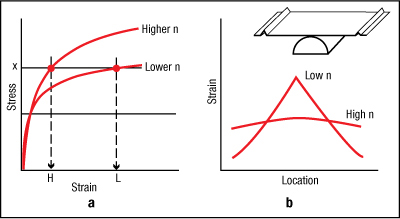

Fig. 3—The higher rate of work hardening (higher n-value) in schematic a allows the same stress increase to be attained with less strain. This reduces the severity of the strain gradient (schematic b).
If a small amount of work hardening does such an excellent job of preventing a sharp strain gradient, why would one need a large amount of work hardening? Remember that the two previous examples used a flat sample that was uniormly loaded in tension throughout its entire length. Most sheetmetal stampings are more complex and generally involve a punch being pushed into the sheetmetal blank (Fig. 3b). This local application of the punch force plus the bending deformation often concentrates the deformation in one area. The amount of stress in the forming area can be much higher than the stress in the surrounding areas. A strain gradient wants to develop.
A material with a low amount of work hardening must undergo a large amount of strain before the rest of stamping can begin contributing to the deformation. In Fig. 3a, assume a stress level of x is required to yield the entire blank. The lower n-value sheetmetal must deform to a high strain level (L) to achieve a stress of x necessary to yield the rest of the blank. The high strain under the punch and the low strain in the rest of the blank create a severe strain gradient (Fig. 3b). However, a higher n-value sheetmetal (Fig. 3a) reaches the same stress level of x with a much smaller level of strain (H) that results in a lesser strain gradient (Fig. 3b).
