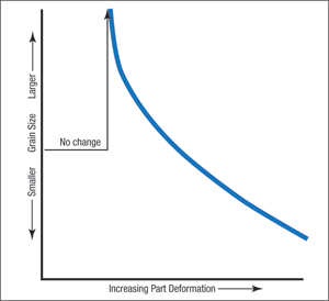

Continuous annealing lines (replacing older box-anneal furnaces) will sometimes experience a stoppage, for any number of reasons. The portion of the coil stopped in the heating section of the furnace continues to heat, causing the existing grain size to grow to a 00 or larger. Steel-mill procedures call for this affected area of the steel to be cut out and scrapped. But what if the overheated section of the coil remains in the coil and is sent to a press shop to make large automotive floor pans? Any stretched features in the panel will be
cold working plus heat energy cause wide range of recrystalized grain size
Fig. 2—Energy of cold working plus heat energy from an annealing furnace can cause a wide range of recrystallized grain sizes in a part. The areas with very large grains exhibit poor stretchability.
covered with tears or cracks, and the sheet surface might resemble divots on a golf tee—absolute proof that huge grain size does not contribute to good stretchability.
As the steel is formed and cold worked, the equiaxed grains elongate in the direction of the deformation, become thinner and are cold worked. Some companies have tried to anneal the partially formed part back to its as-received grain structure in hopes of restoring the original stretchability for further forming. This annealing can backfire. When steel mills anneal their cold-rolled steel, the entire coil has been uniformly cold worked by about 70 percent, and then given a thorough anneal. When a metal stamper forms a part, some areas receive very little cold work while other areas receive heavy cold work.
To anneal or recrystallize the microstructure (Fig. 2) requires sufficient energy, provided by a combination of the cold work already in the part and the heat from the annealing furnace. For much of the stamped part, insufficient energy is available to recrystallize the grain size—nothing happens in those areas. However, at some part locations, enough energy is available to crystallize one grain, which will grow by absorbing its neighbor grains. Other areas of the part may have sufficient cold work to trigger different amounts of properly sized grains. MF
