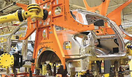

This isn’t to say that aluminum-intensive body structures are not possible—the market offers many examples. However, they skew toward more expensive vehicles where lightweighting for fuel-economy improvements is not a primary issue and sheetmetal cost becomes a smaller percentage of the transaction price. Improved crash performance comes with higher strength as well as with components having crash-resistant design elements such as closed sections, larger flanges or more shape—all possibly requiring greater formability from higher-strength aluminum grades. Placing more shape into a part also increases stiffness. Consider a piece of paper: It’s pretty flimsy, but place a crease down the center and it becomes more rigid. Additional shapes placed into parts to restrict flexing include darts, beads and ribs.
Furthermore, these parts must be joined in a robust, high-speed, cost-effective manner. Ford spent nearly $1 billion to rebuild an F-150 plant to stamp and assemble the aluminum-intensive cab and bed, and join it to a steel frame. This financial hurdle may limit the number of automakers willing to go all-in and make an aluminum-intensive body structure. However, the number of closure or swing panels made from aluminum alloys continues to grow. MF
