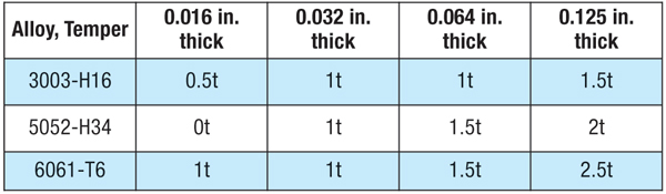

Minimum bend radii for select alloys and material thickness
Table 3—Minimum Bend Radii for Select Alloys and Material Thickness

Bending aluminum requires special attention of the die designer. While for most steels the minimum bending radius relative to sheet thickness is approximately constant, primarily because ductility (total elongation) tends to be the limiting factor, this is not the case with aluminum. In general, the ratio of bend radius to sheet thickness will increase with sheet thickness (Table 3). MF
