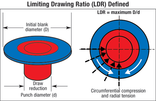

Tooling Geometry for Cup Drawing
Drawing ratio is the relationship between initial blank diameter and the punch diameter (illustration). If the draw ratio is too large, the material does not flow and may stretch extensively. Successful deep draws have minimal stretching because the displacement of material is primarily in compression. Forming aluminum works a lot like a tube of toothpaste: Squeezing (compressing) the tube forms a bead of paste. If one were to pull on the bead—placing it into tension—it would pull apart immediately. This occurs because toothpaste has no stretching capability. This analogy also can be applied to aluminum sheetmetal. For example, aluminum beverage cans are produced from full hard aluminum blanks, which have practically no stretching capability. The manufacturing process includes cupping, redrawing, ironing and necking. All are compressive forming modes.
Proper blank size is extremely important for aluminum products. The area for the first draw must be equivalent to the area in the final draw reduction. If the area is greater, oil canning, buckling, and wrinkling become major problems due to excess material. If the area of the first draw is less than the final draw, tensile failures result due to stretching.
Draw-reduction ratios will vary depending on the aluminum grade being formed. Some grades of aluminum can have limiting draw ratios similar to that of steel, while others have much less. When cup drawing aluminum alloys, keep the limiting draw ratio (LDR) below 1.6 unless you have previous experience with the particular alloy you are working with. An LDR of 1.6 is equivalent to approximately 38-percent reduction for the first draw. Subsequent redraw percentages should be approximately 22, 17 and 12 percent, assuming the ratio of material thickness to blank diameter (t/D*100) is 0.25 or greater.
