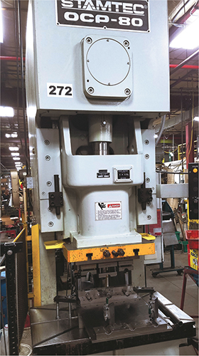

A Stamtec 30-ton secondary press, equipped with tooling designed and built by MMP, punches and fabricates the tubing.

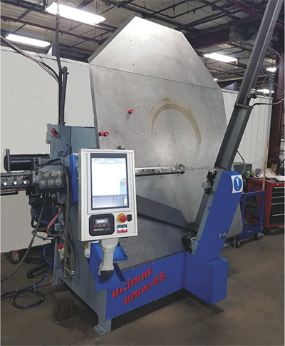

MMP employs this Ultimat UMW-65 two-axis PC-controlled wire-forming and welding machine to produce reshored parts.

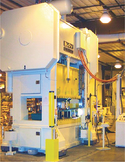

Twin 400-ton Blow servo-press lines stamp out subassembly parts.

Recognizing that stellar efforts to bring back jobs deserve recognition, the Reshoring Initiative, in conjunction with the Precision Metalforming Association (PMA), announced the winner of its First National Reshoring Award: Mitchell Metal Products (MMP), Merrill, WI, a company that, since the early 1990s, has been reshoring products for its customers. One of Mitchell’s most recent successes—a reshored cultivator-handle subassembly that in 2016 went from 4500/yr. made overseas to 30,000/yr. made in Wisconsin—gained MMP the award. The product is made using 13-gauge cold-rolled steel; 14-gauge electro-welded tubing with an 0.75-in. OD; and a type 1018 commercial-quality 000-gauge wire. Equipment used to make the part includes: twin 400-ton Blow servo-press lines for the stampings; a Minster 70-ton open-back inclinable press for tube fabrication using custom tooling by MMP; a Stamtec OCP-80 30-ton secondary press, equipped with MMP-designed and -built tooling that punches and fabricates the tubing; a pneumatically controlled assembly station, designed and built by MMP; and an Ultimat UMW-65 2-axis PC-controlled wire-forming and welding machine, producing wire forms for the kickstand subassembly.
“The bracket stamping for the kickstand is produced on an 11-station progressive tool,” explains Tim Zimmerman, MMP president. “The bracket is highly formed with close-tolerance extruded holes, which create the pivot point for the wire-formed support. Alignment of the holes, critical to function, is assured after extruding via use of side-cam punches in one of the final stations. And faster cycle time—from 3 min. before to 75 sec. now—was accomplished thanks to the efforts of our tooling department, which developed a semiautomatic assembly center that cut the kickstand assembly time in half. This proved to be a key innovation.
