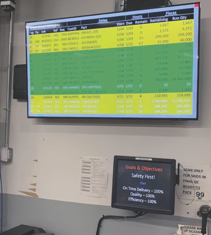

When Connecticut Spring & Stamping (CSS), Farmington, CT, sought to improve its ability to more efficiently schedule its 600 work centers and improve on-time delivery and customer satisfaction, it turned to ERP software from Global Shop Solutions to help effectively run and simplify its job shop. Among the capabilities gained:

One improvement for CSS came from using APS to electronically send scheduling data to large monitors stationed in every department. Previously, workers had to log into the ERP system to know which job to work on; now they simply look at the monitors to know what to be working on in the moment and what’s coming next.
“Having live scheduling data at each work center definitely has improved our workflow,” says Dicke. “The information is always accurate because it comes straight from APS, and workers don’t stand around wondering what to do next.”
