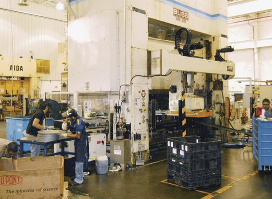

Operators at the Bliss 900-ton press feed blanks into an idle station in the seven-station transfer die, which consumes nearly every cubic inch of available press space. The transfer station lifts up and out of the when Bettcher needs to run the press in the progressive-die mode, using a stationary coil-feed line (far right).

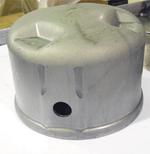

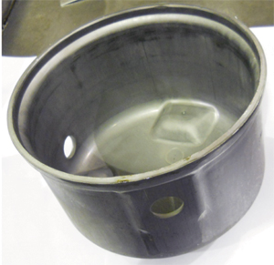

Early in 2011, Bettcher tooling-project engineer Gary James faced the challenge of engineering a process to deep-draw two families of parts for a compressor shell. Upper shells are of 0.155-in.-thick steel with draw height ranging from 6.5 to 8.5 in.; bottom shells are of 0.215-in. steel, with a 7-in. draw height. While Bettcher could easily have formed these parts in any of its hydraulic presses, doing so would have required secondary operations; it sought to run the parts from blank to complete, with holes and forms, in one operation.

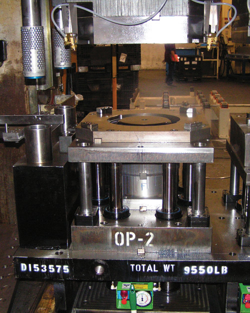

The process calls for deep drawing in the second and third die stations (the first station is an idle). Flanges are then flattened, trimmed and wiped, and holes pierced. The high viscosity of the draw lubricant, combined with the limited space available in the die, required use of four high-pressure piston spray nozzles to obtain full coverage at the two draw stations (shown here).
Spraying the lubricant directly inside the die ensures placement of the lube exactly where it’s needed, when it’s needed, says James. And, using the Pax airless-spray system, there’s no concern with atomization and mist. The lube adheres well to the workpiece material and to the tooling, ultimately minimizing lubricant consumption compared to alternative methods.

While Walker originally planned for three nozzles per draw station, it found that four per station were needed to obtain adequate coverage in the draw stations; two nozzles suffice in the flanging operation. The system can cycle each line as quickly as 300 cycles/ min., and with each cycle can apply as much as 0.2 oz. of lubricant per line.
The Bliss press has an 18-in. stroke; the die, which consumes nearly every cubic inch of available press space, measures 140 in. long by 38 in. wide, and stands 4 ft. tall. “With the high viscosity of the lube, combined with the limited space available in the die, we could not obtain a wide enough spray pattern with three nozzles to cover the area,” says Walker Tool & Die project manager Jim Rickner. Hence the additions of a fourth nozzle in each of the two draw stations.

To optimize the transfer cycle and maximize cycle time, Bettcher opted to have the press rewired and programmed (by Enprotech Mechanical Services) to operate in the single-cycle demand mode. Here, the press stops momentarily at the top of each stroke to allow enough time for the transfer system to index.
Upper shells (left) are drawn from 0.155-in.-thick steel with draw height ranging from 6.5 to 8.5 in.; bottom shells are of 0.215-in. steel, with a 7-in. draw height.

Retrofitting the Bliss press for this job, which has been running since July 2011 and consumes 60 percent of the press’s capacity, says James, also required some unique die engineering by Walker. First, since the press had typically run coil-fed progressive dies, a full feed line resides on one end. Now, a blank feeder (a Linear Transfer unit) resides on the opposite end of the press. To avoid having to move out the coil line when blank feeding the deep-draw job, to enable efficient removal of the finished parts Walker had to engineer the die to allow the parts to exit from the front of the press rather than through the window.
“We had to cut the corner off of the die,” says Walker Tool & Die engineering manager Mark Sytsma, “to allow the parts to exit in front of the post. We then integrated a conveyor to index the parts back toward the center of the press so that an operator can handle them.” MF
