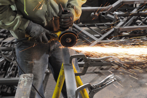

Right-angle grinders, with their wheels turned from the tool at a right angle, are a common tool for cutting, grinding and surface finishing.
When choosing a cutting or grinding wheel or flap disc, an operator needs to select one with an RPM rating equal to or higher than that of the tool in use. That is, use larger wheels with lower-RPM tools, and generally smaller wheels with higher-RPM tools.

Common tools for cutting, grinding and surface finishing include an electric or pneumatic right-angle grinder with which cutting wheels, flap discs and grinding wheels frequently are used.
Another: die grinders for small spaces and with smaller-diameter products or products with stems attached. Die grinders can be electric, though most are pneumatic. When the setup cannot accommodate the footprint of a right-angle or die grinder, there’s the inline grinder. With this option, the wheel is perpendicular to the straight end of the tool, unlike a right-angle-grinder wheel, which is located to a right angle from the tool itself.
