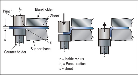

Flanging with Counter Pressure
Fig. 7—Flanging with Counter Pressure [4]

Bending with counter pressure is accomplished by bending a flange while holding the material between a punch and pressure pad (Fig. 7). This restricts the formation of folds or wrinkles in shrink flank flanges and minimizes edge stretching and tearing in stretch flanges. The application of counter pressure also helps to reduce springback.
