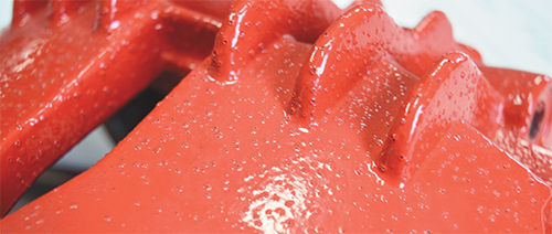

Trapped plating chemicals inside of porous parts can be released during the curing process, causing pinholes and bubbles in powder coating. |

A metal surface has many microscopic pores that can trap plating chemicals.
Later, when powder coaters cure their powder applications—usually at temperatures of approximately 350 F—these residual chemicals turn to gases and release through the surface of the powder, creating pinholes or bubbles in the coated surface that make the finished product unacceptable.
