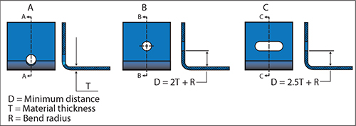

  • Minimum distance between the bend and hole (Fig. 2)
When a workpiece is to be formed, minimum hole size relates to material thickness and bend radius. Maintaining a minimum distance between the bend line and the hole of twice the workpiece thickness plus the bend radius will avoid hole deformation during forming (Fig. 2A). Higher punching loads will cause the workpiece to undergo permanent deformation, reducing strength and load-carrying capacity.

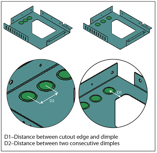

  • Distance between two consecutive dimples, as well as dimples and cutouts (Fig. 3)
 Fig. 4—Bend relief protects against edge tears.Fig. 5—Sufficient bend radius protects against excess stress.
While assigning form features such as dimples on sheetmetal, fabricators must take care when assigning the features. Cutouts in the workpiece can cause the material near the dimples to fracture during punching. To avoid such fractures, maintain a distance (D1) between the cutout edge and the dimple of 4T plus the inner radius of the dimple.
Here, as with piercing, when the form station lacks sufficient clearance between the previously formed dimples and the successive dimple, the previously formed dimples can become flattened. To eliminate distortion, we recommend a minimum distance (D2) between two dimples of 4T plus the dimple radius.

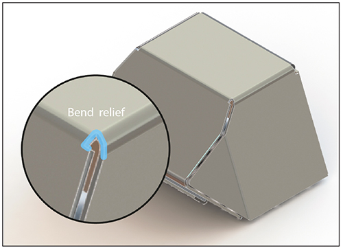

Other DFM guidelines we recommend to sheetmetal-fabrication designers are those related to bend relief, to avoid the springback effect in the material. Overlooking the importance of these features not only will increase the number of ECOs but also will result in increased scrap and related costs.

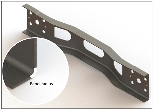

Providing bend relief (Fig. 4) near the bends in the workpiece will avoid tearing at the edge of the material and also provide clearance to ease any downstream operations. In addition, providing a sufficient bend radius (Fig. 5) near the bends will ensure that the workpiece material does not undergo stress beyond its maximum limits and will not fail prematurely. Providing accurate bend-radius calculation also helps in reducing stress concentration near the bend.

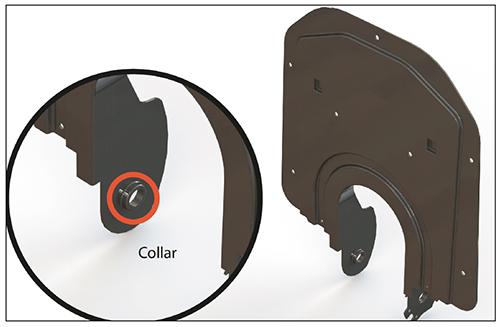

Lastly, collars (Fig. 6) provide extra stiffness to the sheetmetal at flanges, especially near pierced areas. Collars will balance shear stress caused by the piercing operation. MF
