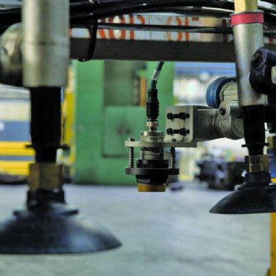

Brankamp control screenWhile aware of technology available to address slug detection in the targeted application, production demands delayed implementation until about a year ago, according to Smutny and Casares. At that point, with a die under development in the toolroom, the team decided to upgrade sensing capability.

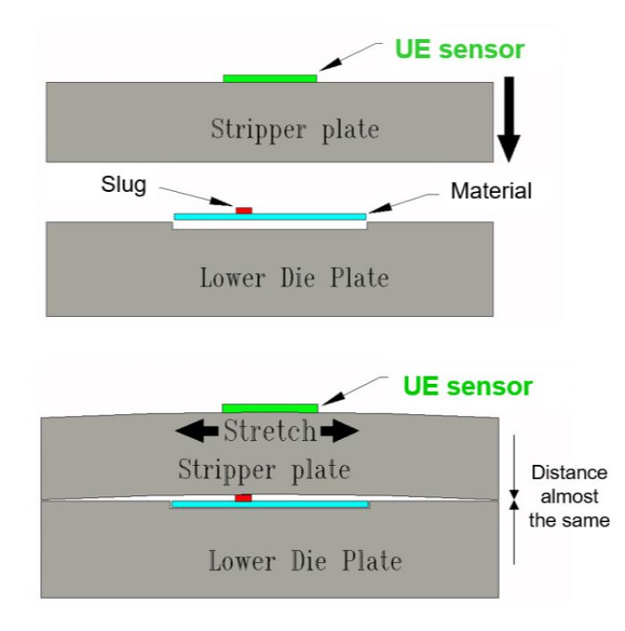

New Setup Senses Stripper-Plate Stretching
More reliable and simplified slug detection arrived via Brankamp Ultra Emission (UE) monitoring technology from Marposs Monitoring Solutions GmbH. Strong UE piezoelectric sensors in this application, operating with each press stroke, measure not the gaps at the edges of stripper plates but the amount of stretch across the top of the plate, caused by a slug-buildup bulge. The sensors work by detecting electrical charges produced in solid materials—such as the stripper plate in this application—due to mechanical stress, in this case the stretched top surface of the plate.
“This technology picks up the distance change across the top of the stripper plate, which indicates stretching,” reiterates Bortolameolli, noting along with Smutny that integration with the press line’s upgraded inhouse controls was a relatively simple affair.

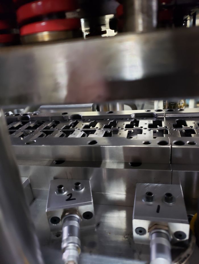

“The Brankamp standalone system monitors only the die, where we use a PLC that runs the press, monitors the feeder and monitors the parts count,” Smutny explains. “To integrate, we just employ a dry contact—which operates essentially as an on/off switch—between the Brankamp system and our control. Should the sensors detect a problem state, we simply disengage the clutch on our control side to stop the press.”
Installing this setup did require some work to install UE sensors in the die shoe. Anticipating these and other modifications, the Schneider Electric team, not wanting to halt current production, decided to task an inhouse tooling engineer, assisted by Marposs engineers, to help install the setup during development of a new die.
