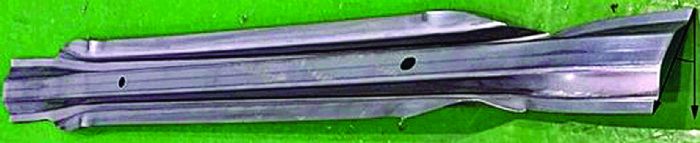

Roll forming with 3D bending—This approach, also called 3D roll and sweep by Shape Corp., which developed the process for fabricating 3D-shaped tubes for roof-rail and A-pillar applications, can replace hydroforming to create smaller profiles. The result is improved driver visibility, added interior space and better airbag packaging. When used in the Mustang Mach E and 6th-generation Ford Explorer and Escape, the process improved strength-to-weight ratio by more than 50 percent and led to an overall mass reduction of 2.8 to 4.5 kg per vehicle.
Flexible roll forming—This process employs CNC-directed forming rolls that can move axially and also rotate to follow part contours. Thus, it allows the forming of parts whose cross-sections change over their lengths.

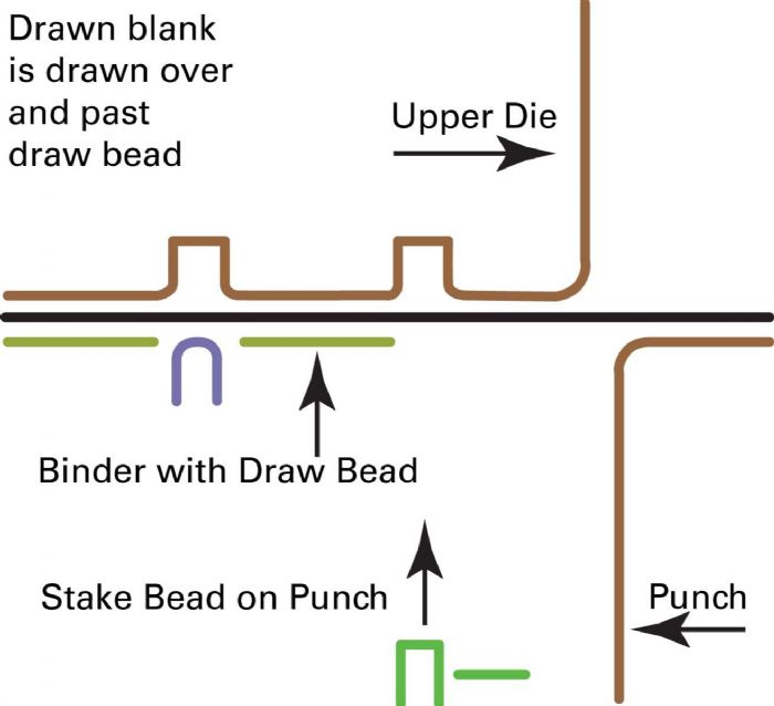

Online draw-in measurement and active blankholder-force (BHF) control—Used by Volkswagen during deep drawing in specific applications, active BHF control helps to control material draw-in. Increasing BHF helps to avoid wrinkling, but excessive BHF may lead to cracks. While typically the deep-drawing process applies a constant blankholder force throughout the stroke using either a hydraulic cushion or nitrogen cylinders, VW AG uses lasers to measure draw-in during the forming process and then locally adjusts BHF using piezo-actuators. It applies the technique for forming the steel spare-wheel well of several VW models, as well as the aluminum hood outer of the Audi A3.

Combination beads to control springback—In a presentation at AISI’s 2021 Great Designs in Steel conference, FCA’s DJ Zhou, presenting on behalf of AISI’s Auto/Steel Partnership and AutoForm, described how different bead configurations outside the draw area can help to control springback. Specifically, researchers are studying the use of draw beads and stake beads to provide for stretch at the end of the stroke, to remove stress from the part sidewalls. MF
