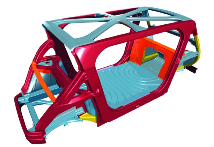

Steel_E-Motive_Body_Structure_three-quarter-sideProviding a case study of hot forming of high-strength aluminum is a duo from Tier One metal former fischer Group. Its new state-of-the-art production plant in Achern, Germany, has opened new possibilities in the design and construction of complex, high-strength, lightweight-aluminum components. Reporting on its progress for conference attendees: business-development managers Marc Schweizer and Thorsten Junge.
“High-strength 6000- and 7000-series aluminum alloys offer the opportunity for weight reduction in the automotive industry as well as other industries forming aluminum sheet,” says Schweizer. “Until now, the production of automotive body-in-white components from these materials using conventional processes has been possible only to a limited extent. We’ve recently introduced aluminum hot forming using the hot-form quench (HFQ) process, with great success.”
The process comprises three main steps: solution annealing of the shaped blank at 450-550 C; rapid forming and simultaneous quenching of the component in the forming tool; and artificial aging at 180-200 C to achieve the final mechanical properties. Using the process to form 6000-series alloys results in tensile strengths exceeding 390 MPa, the duo report, and for 7000-series alloys material strength can exceed 560 MPa, while delivering tight tolerances with very high repeatability.

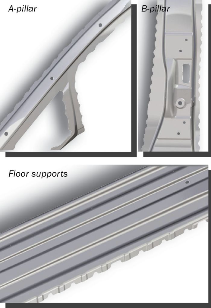

Other important applications for the hot stamping process come into play as automotive engineers turn their attention to the development of ride-sharing vehicles that, in the not-too-distant-future, promise to challenge stampers to take on newer and even higher-strength steels. This comes to light in the just-released Steel E-Motive fully autonomous electric-vehicle body structure concept. Developed by WorldAutoSteel, the resulting structure consists of 33-percent press-hardened steel, achieving an average body-structure tensile strength of 1259 MPa. Steel E-Motive’s materials applications include 66-percent steels with ultimate tensile strengths of 1000 MPa or greater. Leveraging this impressive materials portfolio, Steel E-Motive achieves a body-structure mass of 282 kg., 25 percent lower compared to benchmark vehicles of a similar volumetric footprint.
This presentation, by WorldAutoSteel technical director George Coates, will take a deep dive into the most significant applications for hot stamping that contribute to the overall success of this 3-yr. project, including innovative features such as a press-hardened glance beam, stamped from 1500-MPa steels. In addition, the concept vehicle features a door ring fabricated from a tailor-welded blank of various press-hardened steels, with A- and C-pillars directly aligned with front and rear occupants’ seating positions.
