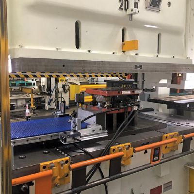

…to implementing part-feed automation? “When you’re trying to add automation to presses running tooling not originally designed for automation,” Wenzel says, “often the parts must transfer at varying heights above the bolster for some die stations. While a simple chore for an operator, automation setups ideally require that part load and unload simultaneously occur at all die stations. Unless the stamper can adjust and modify the tooling, the automation must emulate an operator’s moves, limiting its operating speed.”
Other concerns:
- Scrap must shed automatically, or be capable of being picked up and removed by the automation.
- The part should be lifted by the tooling in the upstroke to make it easier to grip and lift, saving cycle time.
- Where possible on existing and on all new tooling, remove anything in path of the automation to allow shorter, faster movements. This may require, for example, moving tool guideposts.
- The tooling must provide “nesting” guidance for the part so that it can be released and then located precisely as it drops into the tool.
Also be aware, Wenzel says, that part-transfer automation is sensitive to the location of the die in the press. With manually tended press lines, the die need not be precisely and repeatedly located in the press from run to run; the operators can adjust. However, automation requires precise, repeatable die locating every time a job runs. This typically requires stampers to modify the tooling by adding some sort of die-locating mechanism.

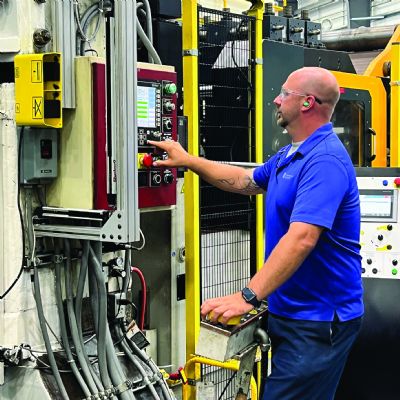

“We also see the need to upgrade press controls in some cases,” Wenzel adds. “Stampers with older controls on their presses may find them unsuitable for integration to automation. Confer with your automation supplier regarding the required I/O and functions to learn if your press controls are up to the task.
“And, think about the guarding when adding automation,” he continues. “Automation brings safeguarding concerns beyond those related to the point of operation; you also must guard the automation itself because it moves and can cause injury. Additionally, the automation moves stamped parts potentially weighing dozens if not hundreds of pounds, quickly in and out of the press, and sometimes from press to press separated by potentially 40 or more feet. The automation losing control of the part mid-move creates another hazard.
“What metal formers sometimes miss in their initial layout work,” Wenzel adds, “is that often the automation will require fencing well out from the press(es) to encapsulate the fast-moving automation and the parts being carried. It’s important to thoroughly understand the OSHA and ANSI guarding standards that must be followed when adding automation.”

“One aspect of cobots that people might overlook when trying to automate a press,” he says: “Cobots are great because you do not need to guard the cobot itself, but don’t forget that you still need to guard the press. On many press controls, if you put a light curtain around the point of operation and then pass through the light with the automation, the machine will drop out of automatic mode. This requires that an operator hit a ‘prior action’ button to arm the system.
“Such a setup will not work with an automated system,” Wenzel continues. “In these instances, the robot will need to be inside of a guard protecting both the automation and the press. So, if the robot must be inside of the guard anyway, it often is more productive to run a faster industrial robot than the slower moving cobot.”
Robot Mode
Some newer press controls have a “robot mode” setting for automatic single-stroke mode—created specifically for automated press tending. “If the press is stopped at top, you can penetrate the light curtain, then leave,” Wenzel explains, “and the press will remain in automatic mode. In these cases, a cobot would be fine. But because many controls do not have this feature, stampers should investigate how their press control will react when automation passes through the guarding.”
One press control with this newer robot mode: Link Systems’ OmniLink 5100. “The Type 3-Robot Mode in the Link controls,” explains James Barrett, president of Link Systems, “is an automatic single-stroke setting that allows a robot, transfer system or other automation device to not only pass through a light curtain (configured to be muted in the upstroke) on the upstroke in the process of starting the transfer, but to also finish the transfer with the press stopped at the top of the stroke, where the light curtain may no longer be muted, provided that the automatic single-stroke run signal is still low—without disarming the mode. If the light curtain remains interrupted when the ‘go’ signal is received, not only will the press not stroke, but automatic single-stroke is disarmed, and an operator must press the prior action button and hit the palm buttons to re-arm the mode after the light curtain is cleared and all other running conditions have been satisfied.
“This most often is used in heavily automated operations,” Barrett adds, “often in a line of presses with robotic transfers between or within the presses. For instance, we see this with large or ungainly appliance or automotive parts that might be roll- or blank-fed into the first press in a line and then undergo further operations on additional presses and/or other machines, where the best way to transfer the parts among machines is with special manipulators. Another typical application: a transfer system that must reach in past a light curtain used for operator protection during setup or troubleshooting operations, when the nature of the die or process results in the press having to stop at top to complete the transfer. This Robot Mode of control can eliminate the need for complex logic and/or interlocks to disable the curtains during automatic operation.
“We have a long history of working with complex automation,” Barrett concludes, “including integrations with transfer systems that let our control signal a transfer system that the press has been requested to run, letting the transfer move from a parked to ready position, and then allowing it to signal the control to actually initiate the stroke. We also have functions that allow us to work effectively in concert with safety PLCs that coordinate an entire line for fully automatic job changeover as well as line operation. While some of these functions can be accomplished using external equipment, that can increase the cost and complexity of the final solution while greatly reducing diagnostic clarity.” MF
