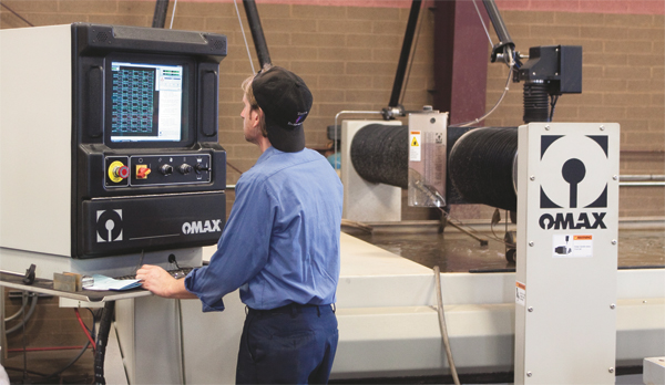

Tru-Fab owner John Stegh works on a plate nest at the machine control tending to the firm’s Omax bridge-style 80X series JetMachining Center, with x-y travel to 165 by 80 in. |

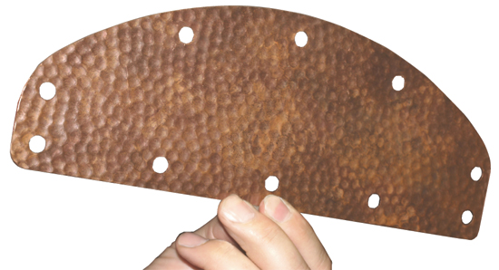

Stegh counts on his waterjet-cutting machines to satisfy customers looking for fabricated components from reflective alloys, such as this motorcycle foot pedal fabricated from heavily dimpled 0.045-in.-thick copper-alloy sheet. “Our lasers could never have cut this material, and would have struggled to pierce all of the holes, but waterjet cutting worked like a charm,” he says. |

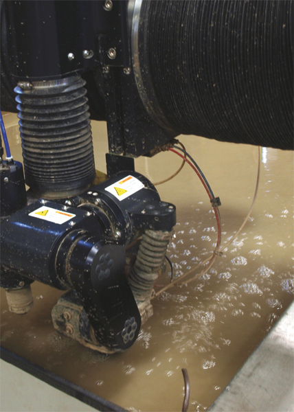

Stegh particularly appreciates the Tilt-A-Jet accessory cutting head, designed to achieve a nearly zero taper. He has it installed on his Model 55100 machine. The cutting head positions the nozzle at an angle determined by the Omax Intelli-Max software—based on material type and thickness, and cutting speed—to compensate for predicted taper. This moves the tapered edge to the scrap rather than the workpiece. |
Stegh describes his company as a “metal-fabrication shop with the ability to do a lot more,” a mantra that has proven itself over and over as he has grown the shop’s capabilities. That growth includes the acquisition of two waterjet-cutting machines, both from Omax Corp., Kent, WA. In 2008 it brought in a cantilever-style Model 55100 Jet-Machining Center, with workpiece capacity to 55 by 100 in. In 2010, Stegh upsized to Omax’s bridge-style 80X series JetMachining Center, with x-y travel to 165 by 80 in. Features include linear drives and a programmable motorized z-axis. With the machines at or near capacity, Stegh seems likely to purchase a third waterjet machine by the end of 2012.

In addition to metal-alloy work, Stegh also waterjet-cuts nonmetals such as rubber and plastic. But he points out in particular how well the process performs on reflective alloys—copper and aluminum—where his laser-cutting machines struggle. For example, a customer that modifies motorcycles recently came to Tru-Fab in need of copper-alloy foot-pedal covers, fabricated from heavily dimpled 0.045-in.-thick sheet, and containing several small-diameter holes.
“The lasers could never have cut that material, and really would have struggled to pierce all of the holes, but waterjet cutting worked like a charm,” Stegh says. Tru-Fab fabricated more than 500 of those parts, once again proving that process flexibility is a critical component to consistently satisfying customers.

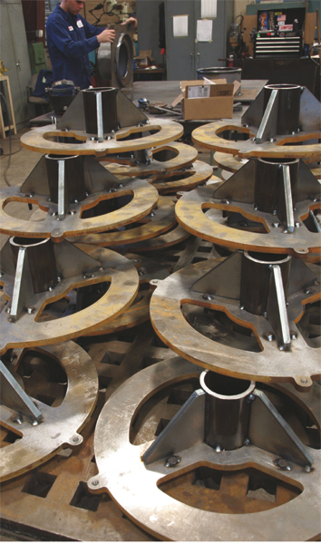

Tru-Fab waterjet-cuts parts from 3⁄8-in.-thick steel plate to fabricate these assemblies used in electrostatic precipitators. |

One Omax feature Stegh particularly appreciates is its Tilt-A-Jet accessory cutting head, designed to achieve a nearly zero taper. He has it installed on the Model 55100.
“While aluminum cuts fairly straight and often does not require compensation,” he says, “steel can taper quite a bit.” Taper occurs because the energy of the waterjet is greater at the top of the cut than at the bottom, resulting in a wider kerf at the top. In some cases, fabricators can experience reverse taper. Here the waterjet removes more material from the bottom of the cut than from the top; the phenomenon can occur during very slow cuts or when working with very soft materials.

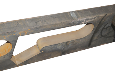

Stegh pointed out this plate skeleton to highlight the edge straightness and quality achieved with waterjet cutting. Shown is 2-in.-thick type 4140 mild steel. “This is wire-EDM-like quality,” he says, “with top-to-bottom straightness within 0.020 in.” |
The Tilt-A-Jet cutting head positions the nozzle at an angle determined by the Omax Intelli-Max software—based on material type and thickness, and cutting speed—to compensate for the predicted taper. This moves the tapered edge to the scrap rather than the workpiece. The head offers programmable tilt to ± 9 deg., as well as 6 in. of vertical travel.
“The parts come off perfectly square with taper-free edges,” says Stegh, “without having to reduce cutting speed—the alternative method to reduce taper. We’re achieving taper as little as 0.003 in. top to bottom on 1-in. steel plate. That’s unheard of, on par with wire-EDM.”
