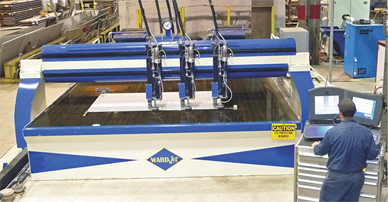

| Metals & Services Co. operates three of these three-headed WardJet waterjet-cutting machines 20 hr./day over three shifts. Using common control platforms among all three machines maximizes scheduling flexibility, according to waterjet coordinator Steve Herff. |
But the centerpiece of the 135,000-sq.-ft. shop is its trio of three-headed waterjet-cutting machines, all WardJet models. The largest of the three, and also the newest (added in 2015), features a 166- by 253-in. cutting table. The others cut on tables measuring 132 by 313 in., and 140 by 187 in.

The workhorse waterjet machines make thousands of inches of cuts in stainless-steel plate as thick as 6 in. week in and week out. “We’ve outfitted all of them to be powerful and large—we don’t ever want to be limited in what we can process,” says Pete Fagan, Metals & Services Co. general manager. “We specifically looked for powerful pumps to drive the three cutting heads (on each machine), without sacrificing cutting speed and quality.” The pumps of choice are Hypertherm HyPrecision 150D models, 60,000-psi dual-intensifier pumps equipped with 150-hp motors and featuring several notable control functions designed to optimize ease of use.

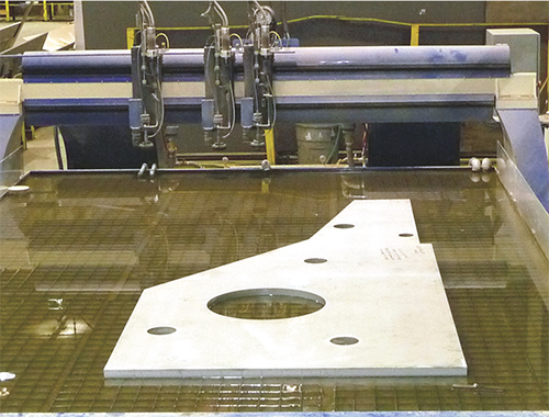

As an example, Fagan describes a recent project from a customer that typically requests plasma cutting. “However, in this case,” he says, “when we looked at the assembly drawings, we noted that the parts required a very smooth surface finish. We talked them into waterjet cutting to eliminate any post-machining operations.”
A high-profile job completed recently by the service center had it cutting ¾-in. stainless plate for Omaha, NE, fabricator Puritan Manufacturing, contracted to build a massive 55,000-lb. sculpture for the University of Nebraska’s sports arena. The sculpture, describes Herff, combined two-side-polished plate with holes cut in some sections through which polished tubes were to be inserted.
“Here I worked closely with the customer to determine the optimum clearance between the tubes and the hole diameter to prevent damaging the surfaces during assembly,” he says. “Waterjet cutting the plates allowed us to meet tight tolerances and achieve the desired surface finish.”

“We run the machines 20 hr./day over three shifts,” adds Fagan. “We’ve outfitted all of them to be powerful and large—we don’t ever want to be limited in what we can process. We specifically looked for powerful pumps to drive the three cutting heads (on each machine), without sacrificing cutting speed and quality.”
The pumps of choice are Hypertherm HyPrecision 150D models, 60,000-psi dual-intensifier pumps rated for a maximum orifice diameter of 0.025 in. They’re equipped with 150-hp motors and feature several notable control functions designed to optimize ease of use. These include what Hypertherm calls advanced intensifier monitoring, for early detection of leakage; an enhanced maintenance interface along with a web-based interface for remote access to system and maintenance performance; and control of intensifier settings during pump operation.
