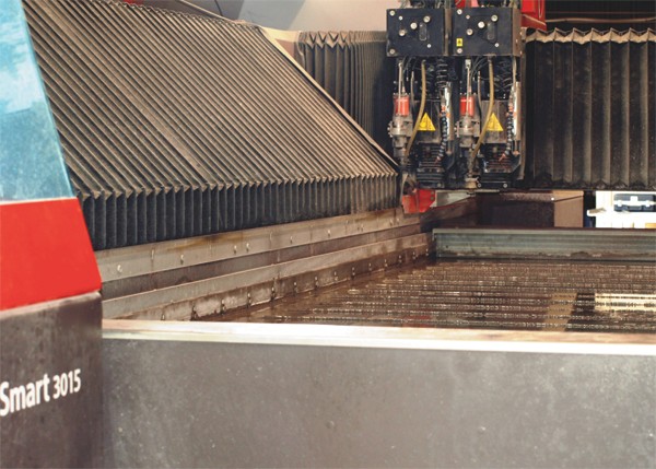

Alliance’s waterjet machine powers two cutting heads. Some 20 percent of its waterjet work would typically be done in the machine shop, with the rest being flat-plate cutting. Maximum workpiece weight, per Bystronic specs, is 790 kg/m2; maximum plate size is 3 by 1.5 m.

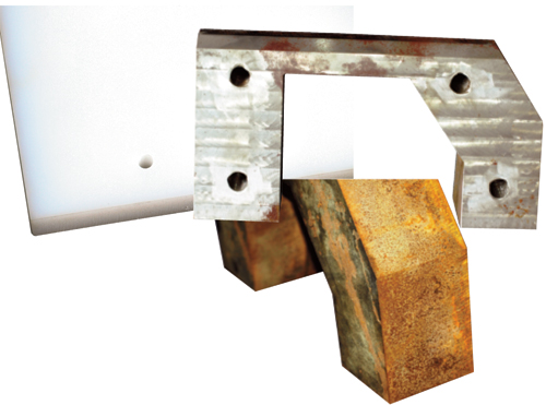

Alliance Laser employs its new waterjet-cutting machine to cut a variety of materials, including UHMW-PE (left), heavy-gauge carbon and stainless steel, and aluminum.
Since Alliance Laser installed its waterjet-cutting machine in January 2012, some 85 percent of its cutting time has been devoted to metallic work. It’s cutting a variety of components, in lot quantities of one to 1000.
“For example, we’re running heavy aluminum parts to 11⁄4 in. thick,” says Stimens, “for a builder of pan-and-tilt systems used in antenna array and satellite dish systems. Here we’re making profile cuts to save on machining time on our CNC machines—we can profile the thick parts on the waterjet, and then send the parts to the machine shop for internal machining.”
Alliance’s waterjet machine powers two cutting heads. Some 20 percent of its waterjet work would typically be done in the machine shop, Stimens says, with the rest being flat-plate cutting. “In January, in conjunction with bringing waterjet cutting inhouse as a core competency,” he says, “we began to take in a lot more work from one of our customers, Textron Marine and Land, requiring us to cut heavy steel plate (2.5 to 3 in. thick) for parts that go into its armored security vehicles (ASVs). We can’t cut that material on our lasers…waterjet is the to go.”
