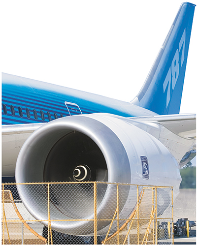

If you’ve flown on a Boeing 787, 747 or 737 lately, you may have seen Arro-Jet Engineering and Consulting’s latest accomplishment. The small waterjet operation, located in Camarillo, CA, has been working almost nonstop for several months cutting dozens of the familiar aluminum covers visible on the Boeing engine’s cowling, known as the leading edge of the fan case. Formed from aluminum and curved for smooth airflow, the leading edge is part of the cowling that directs air into the turbine.

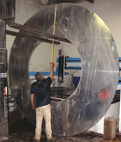

| The metallic-colored leading edge on this Boeing 787 jet-engine cowling began as an aluminum plate at Arro-Jet Engineering and Consulting, where the company used a waterjet machine to cut it as two parts then weld it together. Arro-Jet then shipped the ring to Boeing for additional forming. |

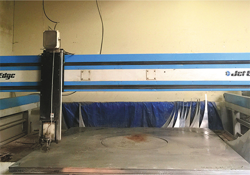

From inside the aircraft, these parts don’t look massive, but stand next to one at Arro-Jet and it towers over you. Arro-Jet cuts the 14 by 14-ft. parts on the largest of its three Jet Edge waterjet systems, an 8 by 13-ft. midrail-gantry system. The company produces more than 20 of these components each month from 0.145-, 0.300- and 0.450-in.-thick aluminum plates—parts so large that they are formed in halves and welded in the center.

| This Boeing cowling piece, at 14 by 14 ft., is hoisted near the 8 by 13-ft. midrail-gantry waterjet-cutting system used to produce it at Arro-Jet. Because the part is so large, it must be welded from two parts to achieve its ring shape. |
Arce cuts the Boeing engine covers at a water pressure of 55,000 psi with a 0.012/0.045-in.-dia. orifice/nozzle combination using 1 lb. of abrasive garnet per minute. Waterjet is ideal for this application because it leaves a smooth edge that doesn’t need to be ground away, Arce says, adding that the cold-cutting process does not leave a heat-affected zone. After Arce processes the parts, he sends them to Boeing, which forms them into their recognizable curved final shapes.

The waterjet system that Arro-Jet uses to cut the Boeing parts supports multiple cutting heads and can cut complex parts from a range of materials. Its design separates the motion system from the catcher tank, eliminating vibration and ensuring high part quality, according to Jet Edge officials.
