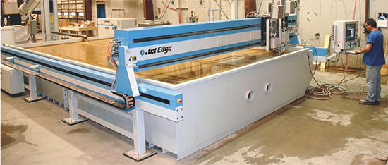

Further enhancing service-center throughput: all 11 of Jacquet’s waterjet-cutting machines are dual -head models, and are run off of 100-hp intensifier pumps. Standoff between the heads is adjustable either automatically (through the cutting program) or manually.
Adding the second cutting head increases machine purchase price by just 20 percent or so, making the decision to effectively double output easy to justify, says Engle. “The twin-head design is a must as we strive to increase our speed to market and reduce turnaround time.
“Also, we experience no decrease in traversing or cutting speed with the second head,” Engle adds, “while holding our tight cutting tolerances.”

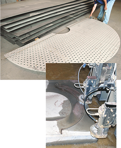

“The trend,” says Engle, “is toward the high end. And that includes the ability to provide beveled cut edges to facilitate welding of cut parts without the need to run the cut edges through a secondary process to add the bevel.”
Three of the firm’s 11 machines have been custom-engineered by Jet Edge to allow them to provide beveled cut edges—machines in Racine, Pottstown and Houston. Applications for this capability include cutting large plates that are then rolled and welded to manufacture tanks and vessels for the oil and gas industry, among other end-use applications. MF
