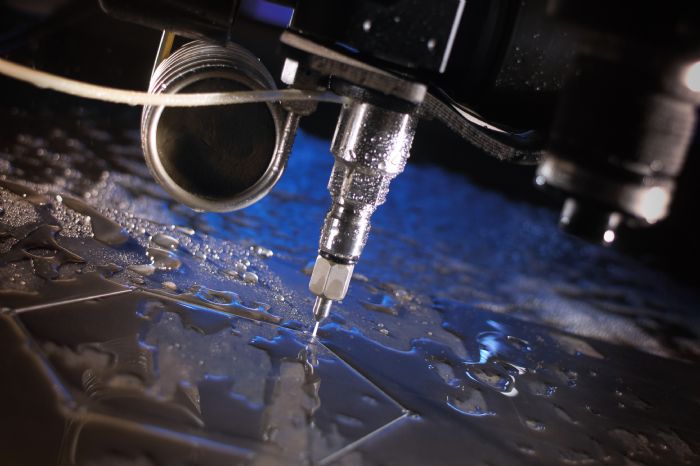

Compared to cutting processes that rely on or produce heat, abrasive waterjet stands alone in its cost-effective ability to produce precise cuts without an HAZ, slag, decarburization, microfractures or the need for secondary processing. In addition, the process easily handles materials that cannot survive heat-based processes. It cuts without altering the molecular structure of the workpiece or producing material stress; requires almost no setup; and can perform secondary processing as well as one-step cutting.
Like OFC, abrasive waterjet can cut thick steel, and like PAC, it is relatively simple to use and can cut uneven surfaces. Like LBC, it makes quick, precise work of thin materials.
Unlike other processes, however, abrasive waterjet does not produce fumes, smoke or dust, and its consumable costs are modest, with no need for volatile gases. With software-based controls, programming an abrasive waterjet system is relatively simple to learn and operators quickly can master advanced programming and processing techniques.
With no heat sources and no direct contact between the cutting equipment and the workpiece, abrasive waterjet excels at dealing with materials that do not melt, cannot tolerate heat or already have undergone heat treatment. While it may cut slower than PAC and LBC, it outperforms OFC on speed.

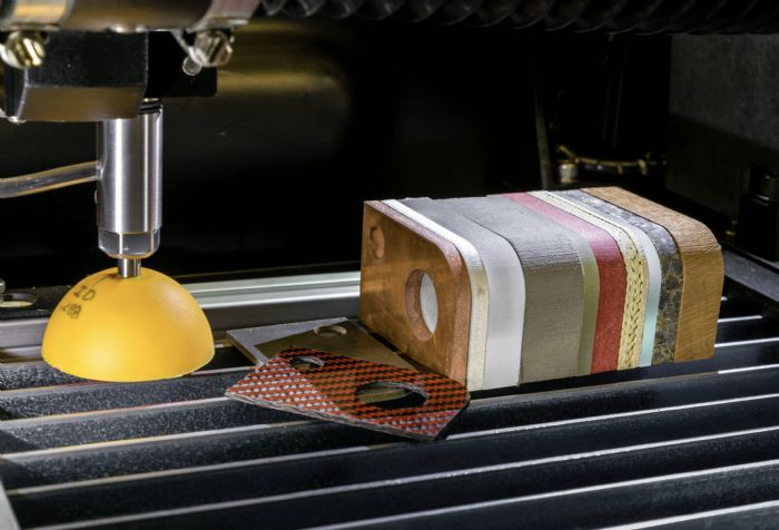

One of abrasive waterjet's foremost advantages is the wide range of reflective, conductive and non-metallic materials that it can cut, including aluminum, brass, cement, composites, fabric, foam, food, glass, granite, leather, paper, plastic, rubber, stainless steel, steel, stone, tile and wood. With smooth cut edges and the ability to process nested parts and intricate paths, waterjet cutting can eliminate secondary processing and enable shops to skip outsourcing on many jobs.
Advanced motion controls enable waterjets to cut with a precision of ±0.005 in., and in some cases to within 0.001 in. Using computer-controlled taper compensation and multiaxis cutting heads can expand process versatility with advanced capabilities, including six-axis cutting.
Available to metal formers are compact waterjet machines that offer portability, second only to the OFC process. Setup time is minimal, and programmed nesting enables maximum yield from raw material. Finally, because abrasive waterjet uses only water and garnet to produce its cutting power, the process can result in far less environmental impact than other cutting processes. MF
