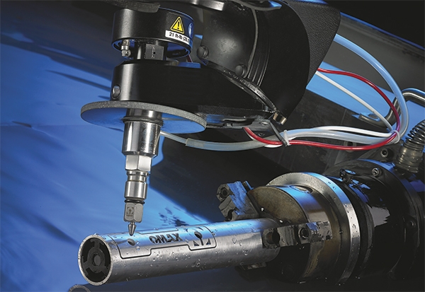

Metalformers enhance the capabilities of their waterjet-cutting machines by adding five-axis and rotary-axis machining, which allow them to increase their part-cutting diversity. |

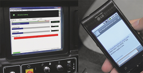

Some suppliers offer machine-control functions to make maintenance proactive rather than reactive. With this monitoring ability, shops can minimize or eliminate unexpected downtime. |
Other performance-enhancing capabilities include five-axis and rotary-axis machining, which allow shops to increase their part-cutting diversity. Machines gain the ability to process a wider range of part types to further increase their productivity potential.
