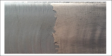

Fig. 2—Steel cut with O2 plasma/air shield with iron-oxide film.
Fig. 3—Steel cut using O2 plasma/air shield with iron-oxide film removed from right side.

Plasma, laser and oxyfuel cutting processes use oxygen when cutting steel, and they leave a thin film of iron oxide on the cut surface. This thin film can be removed easily with an abrasive treatment. However, if not removed, paint applied to the cut surface may flake off (Fig. 2-3).
