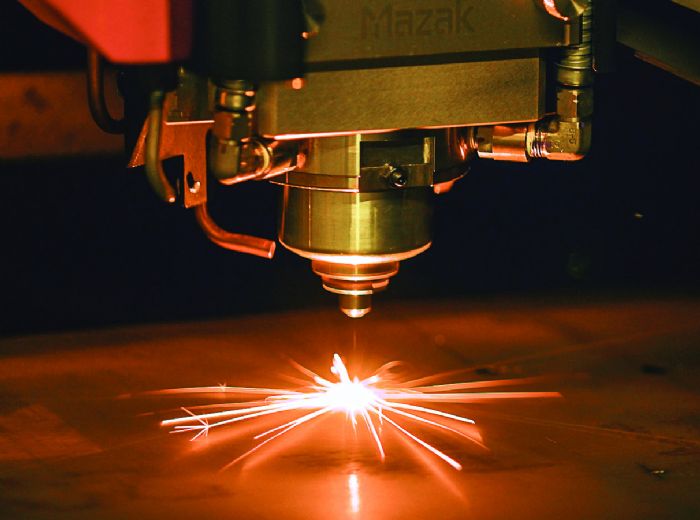

Increased output. After a period of training on the laser, Acampo saw its output multiply by more than 10 times. “I can have a part kicked out in 5 min. vs. 5 weeks,” Edwards says.
Cuts 1-in.-thick material. The laser’s cutting capacity was critical. “If it says it cuts 1-in.-thick material, I need it to cut 1 in., and I need it now,” Edwards explains.

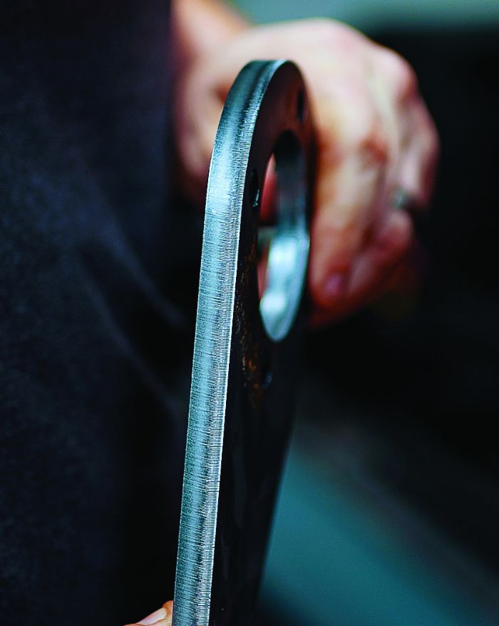

“We cut mild steel plate as thick as 1 in. all the time,” he continues. “That’s the break point. Typically, we have found that other lasers’ break point is ½ in.—everybody can cut ½ in.—and then the next break point is 1 in. That really narrowed the field.”
Cuts small holes. The fiber laser’s capability to cut holes smaller than the material thickness brings additional efficiencies. “The general rule of thumb is that you can laser a hole no smaller than the thickness of the plate,” says Edwards. “Now, we can cut a ¼-in.-dia. hole in a ½-in.-thick sheet,” Edwards says. “We’re cutting tap holes and tapping it right afterward.” He adds that this cannot be done on stainless steel because it work-hardens under heat.
Expanded capabilities. Not only did the cutting machine accelerate production and save costs, it opened new lanes. “As time goes on, we’re designing parts with the laser in mind. We’ve tailored our sales pitch based on the fiber laser’s quality of cut,” he says, adding that “laser cutting inhouse changed the world for us.”

High-pressure-air assist gas. “Lasers consume gas. Right now, gas is okay to use, but in the future, it may not be,” Edwards says. “One of the things that attracted us to the new laser is that it can operate on high-pressure air or straight oxygen, rather than nitrogen. And, it has all of the cutting parameters to perform most of our cutting using high-pressure air. Not having to buy nitrogen has resulted in cost savings as well.”
