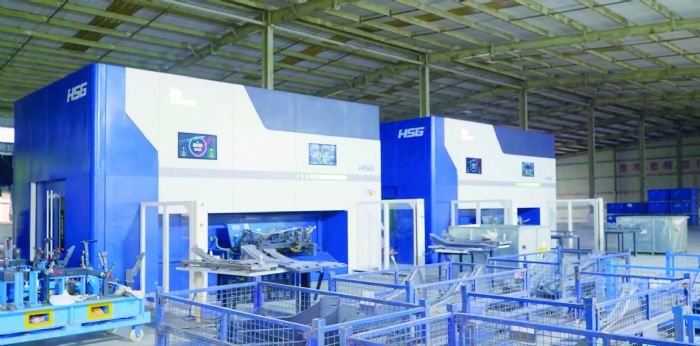

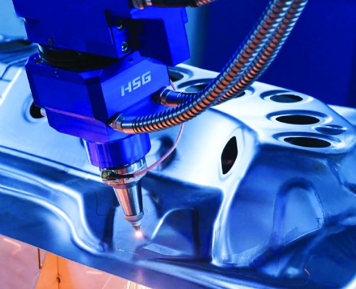

Suppliers of laser cutting machines offer various capabilities and options to best fit certain applications, and provide machines that offer the best bang for the buck for stampers looking to incorporate the technology. For its part, HSG recently has debuted the Laser Cell 3015G, a five-axis laser cutting solution that features an advanced cutting head, high-performance motion control, enhanced safety features, and high productivity and efficiency, according to Benoit. Such an arrangement provides accessible 3D laser cutting technology for stampers while negating the need for hard tooling, and also offers high cutting speeds and automation that help increase productivity while reducing labor costs. And, a variety of layout configurations ease incorporation on shop floors and within production cells.

Complexity: Laser cutting in general gets the call for high-complexity operations, while stamping proves better for low- to medium-complexity. For example, the flexibility of laser cutting machines, especially with the support of 3D cutting heads, allow cutting of complete part contours within a single station—a productivity-boosting solution, according to Benoit.
