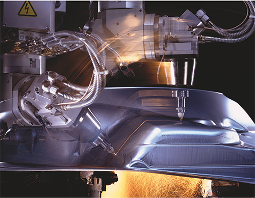

Complex 3D cutting directs the laser beam over angled surfaces and requires countless directional changes. The process requires a five- or six-axis motion system, and with each additional axis comes increased programming complexity.
While the laser-cutting process differs little during 2D or 3D cutting, the motion systems used to deliver the beam differ considerably. When cutting simple 2D shapes in flat sheetmetal using a 2D cutting machine, a two-, 2.5- or three-axis motion system gets the call. When laser cutting 3D parts, the motion system must include an additional two or three axes—a five-axis gantry-style machine or a six-axis robot gain favor.

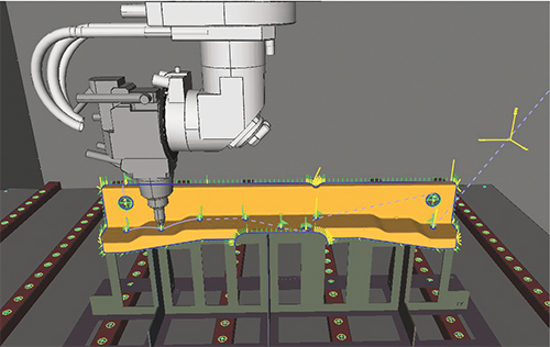

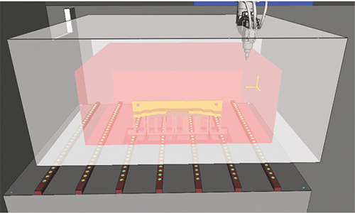

Fig. 1—The programmer’s list of tasks includes locating the part’s CAD file within the work envelope of the machine, properly placing the part on its fixture within the 3D working envelope, represented here as a pink box.

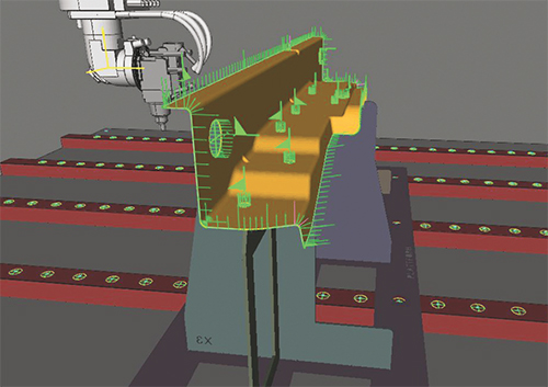

Fig. 3—Since vectors initially are programmed perpendicular to the part surface, head or nozzle collision can exist in internal corners. To account for this, the laser head must be manipulated, typically at an angle to 15 deg., in these areas to create cutting-head clearance.

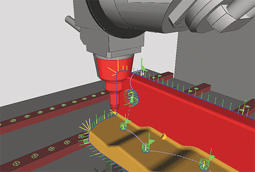

Fig. 4—With all collision areas eliminated and the NC program optimized (shown here), the programmer must then locate a “zero-point” on the part or fixture. He uses this for locating the part in the machine.
Once the programmer has gathered all of the necessary CAD data and is ready to program the 3D part, he then must locate the part’s CAD file within the work envelope of the machine, properly placing the part on its fixture and within the 3D working envelope (Fig. 1—the pink box represents the work envelope of the five-axis machine). After locating the part, he then identifies the cutting contours, which can include interior hole features, external trims, simple shapes or extremely complex geometries. The software will calculate and display the surface perpendicularities around the desired contours, shown as vectors (shown as green lines in Fig. 2). If a programmer needs to program a cut that is not perpendicular to the surface—a bevel cut for example—he can modify the vectors individually, in segments or along the entire contour to the desired cutting angle.

Since vectors initially are programmed perpendicular to the part surface, head or nozzle collision also can exist in internal corners (Fig. 3). To account for this, the laser head must be manipulated, typically at an angle to 15 deg., in these areas to create cutting-head clearance. Any angles greater than 15 degrees will reduce cut quality. Also note than increasing the cutting angle requires adjustment to other cutting parameters, including cutting speed.
The programmer then can manually create additional path points to optimize control of rapid head movement around potential collision areas. When programming rapid movements, we recommend an arced line or curved path, which provides for smooth transitions and will minimize machine wear. Additional considerations also may be required to protect part surfaces and machine or fixture components. Examples might include the cutting of small-diameter tubes, where shielding can be used to protect the surface opposite of where cutting occurs; or changing parameters or cutting angle to minimize damage to machine components when processing highly-reflective materials such as aluminum, particularly when using a CO2 laser.

With all collision areas eliminated and the NC program optimized, the programmer must then locate a “zero-point” on the part or fixture. He uses this for locating the part in the machine (Fig. 4). Ideally, the “zero-point” should be an easily identified and dedicated part feature that can be captured without difficulty with the part and fixture in the machine. Examples include crosshairs, spheres and cones.
