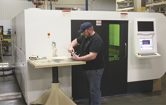

The firm’s competitive advantage also continues to grow as Premier’s staff climbs the learning curve and finds s to squeeze every ounce of productivity from its new machine. Knowing that such a learning curve often can take considerable time to navigate, we were excited to hear of a few notable nuggets of gold the company already has mined as it’s refined its procedures. Kaiser explains.
“We’re learning all the time, trying to cut faster than the charts say we should. And, another focus has been on reducing, or even eliminating, pierce times. For example, on one nested sheet of 8-gauge steel that we process often and which contains hundreds of holes, we fine-tuned the laser focal point and the assist-gas pressure and shaved pierce time from 8 sec. down to 3 sec. That alone trimmed 20 min. from the overall cycle time for the job.
“We’re also cutting thin-gauge sheet (0.071 in. or less) without piercing at all,” Kaiser continues. “On 16-gauge steel, for example, the laser originally was set up to cut at 280 in./min. After removing the pierce, as well as change nozzle style and, again, fine-tuning process parameters, we’re cutting 16 gauge at 1180 in./min.”
One last little efficiency nugget that’s helping quicken the laser’s payback period: Premier has requested that customers order parts in full-sheet quantities. “All of our jobs are quoted per sheet,” Seemann says, “so if a sheet nest can fit 10 parts, that’s the minimum order quantity. We avoid remnant issues—handling, storing, tracking etc.—and in most cases have been able to achieve 90-percent material utilization.”
