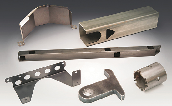

While the firm made its mark fabricating primarily sheet and plate, as its welding department has grown so has its need to fabricate large structural sections. With a substantial amount of its work now comprising structurals—round and square tubing and extrusions to 6-in. dia., with wall thickness to 3⁄8 in.—in addition to plate and sheet to 1.25 in. thick, Jay found itself relying on outside suppliers for 3D cutting.
“We were sending work outside to two or three vendors to support 30 or 40 different assemblies,” says Jameson. “Much of this work comprises very large stock, 10 to 12 ft. long, so we had to find suppliers with large machining centers, or pay for two machining-center setups when a supplier lacked sufficient capacity.”
Fabricating the structural sections also often required sawing and hole drilling, in addition to machining. While Jameson credits the firm’s employees with engineering a solution to keep some of this work inhouse, by developing a fixture enabling tube cutting on its flat-bed three-axis cutting machines, the firm went searching for a better option.

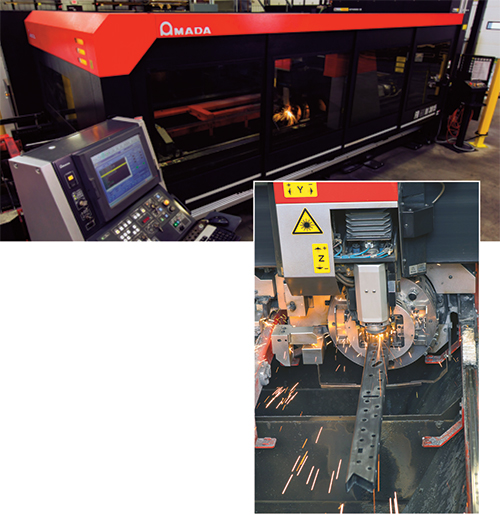

In 2012, Jay purchased this Amada FOM2RI 3015 laser-cutting machine with rotary index station. It can process round tubing 0.75- to 8.66-in. dia. and square tube to 6 in. Maximum tube length: 236.2 in., and 19.6 ft. with one reposition.
In 2012, the search led to investing in an Amada FOM2RI 3015 cutting machine. Its high-speed cutting head features cut-process monitoring (CPM), auto-focus control, a spatter-free pierce function and water-assisted cutting for quick work on plate. And, the head is able to be positioned close to the chuck of the machine’s rotary index. It can process round tubing 0.75- to 8.66-in. dia. and square tube to 6 in. Maximum tube length: 236.2 in., and 19.6 ft. with one reposition.
“With the new laser, we’ve been very successful at returning outsourced work to our shop,” says Robinson. “And, we’re using one machine now to cut holes, cutouts and bend lines in the work. This has freed up other machines, eliminated setups and allowed us to nest several parts in one piece of material to minimize scrap.
“We’re providing higher quality products with shorter lead times,” Robinson continues, “at an attractive price. Basically, we’re providing machined parts at laser costs. We avoid sawing, machining, drilling and chamfering operations.”
