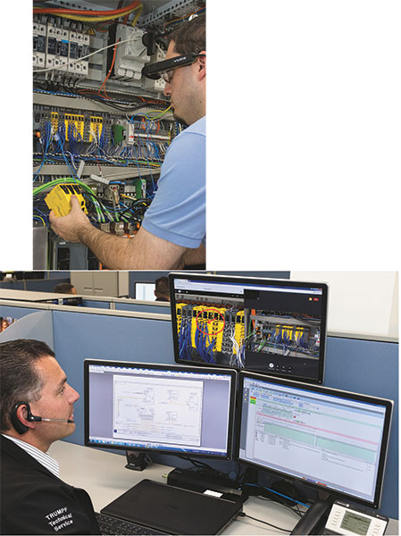

Remote service technology leverages mobile communication between the technician and the technical-service professional. Via hands-free “smart” glasses worn by the technician, he can share live, annotated images and videos (top screen of the photo to the right), engage in dialogue, and receive instruction.
