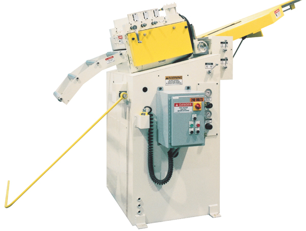

 A heavy-duty straightener (shown) with seven 4-in. dia. work rolls located on 7-in. centers will straighten ¼-in.-thick cold-rolled steel, but will have minimal effect on 0.050-in. cold-rolled steel. Likewise, a straightener designed with seven 3-in.-dia. work rolls located on 5-in. centers will effectively straighten the 0.050-in.-thick steel but will lack the horsepower and roll strength to process ¼-in. material.
For example, a straightener with seven 4-in.-dia. work rolls located on 7-in. centers, and given adequate power and gears, will straighten ¼-in.-thick cold-rolled steel. The same machine will have minimal effect on 0.050-in. cold-rolled steel. Likewise, a straightener designed with seven 3-in.-dia. work rolls located on 5-in. centers will effectively straighten the 0.050-in.-thick steel but will lack the horsepower and roll strength to process ¼-in. material. If an application calls for this type of variation in material thickness, a fundamental decision must be made in regards to the cost effectiveness of building a special machine to meet the full spectrum of needs, versus building a standard machine that will provide optimum straightening at either the light-gauge or heavy-gauge end.
